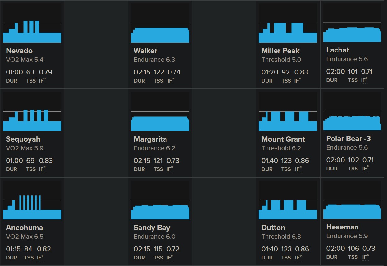

I’m doing the LV climbing road race plan for the second time. Except this time I’m skipping the SS workout (3 intense sessions was too much for me) and replacing it with longer Z2 rides.
However, that side of my brain doesn’t like skipping workouts because I get a sense of completion knowing that I’ve ticked the boxes. And besides that’s why I’m paying for TR.
Ultimately what I would like (which may be in the works?) is the ability to do a mid volume polarised plan. Where I will have two intense workouts (as per usual), and 2 or 3 longer Easy workouts in the 3-4 hour range.
Let me determine how many days and what duration I want to train and customise a polarised plan that meets those needs.
Yes. Easier said than done. I respect that.
It appears as though a lot of people are Frankensteining their low volume plans in a similar way. Just wish it was more structured.
This describes what following a current MV Polarized block would be like. The “2-3 longer easy workouts in the 3-4hr range” is a longer than what our plans would have for most athletes, but you can easily swap the shorter workouts for longer ones using Workout Alternates.

Thanks. On another note; how does TR define polarised? My understanding is it’s approximately 80/20 however, when you look at TR’s MV plan it’s closer to or less than 60/40. Assuming my 3rd grade math is correct… :confused:
What exact metric are you using for your POL split evaluation?
Check out the intro thread for more than a little discussion on how & why TR set the plans the way that they did.
Can confirm. I am no amazing athlete by any means, but every workout I get served is challenging in the right way. If I answer honestly about how a ride feels, AT backs off what I struggle with. This works surprisingly well in the triathlon plans too, where training fatigue comes from swimming and running, which are outside of AT
The 80/20 rule? It’s in their literature, and their HV follows this model.

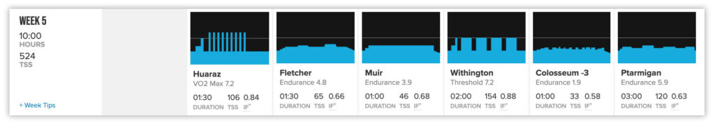

The high-volume 8-week Experimental Polarized Plan incorporates two 3-week loading cycles, each followed by a recovery week. Its total training intensity distribution is
92% Zone 1, 1% Zone 2, and 6% Zone 3
when measured by time-in-zone. Overall it averages about 9h training time per week, with a weekly maximum of 11.5h.
The plan’s 5th week serves as a good example of its overall structure. The previous week is focused on recovery, so this week begins the plan’s second load cycle.
It’s not a bad question. But perhaps mostly a sign that polarized is not that well defined.
Based on number of high intensity workouts, time in zone or the more pragmatic “Do 2 - or occasionally 3 - hard workouts per week - the rest endurance”?
I kinda like the part from the training program that you showed.

People would complain since what is listed above is not polarized training
Lately it seems like a lot of people seem to be clamoring for a plan that is just all Z2
I think 3 intensity sessions is probably too much for a polarised mid-vol plan. And I also think you’d have to define “the rest is endurance”. How many hours on top of intensity is that? If we’re doing 2-3 hours of intensity a week are we adding an additional 5 or 10 hours of easy riding? I don’t know the answers but I think lots of z2 is good and 2 really solid intensity sessions is good.
Probably the million dollar question is; is more Z2 better than some SS? I don’t know the answer.
This is very close to our Traditional Base plan.
