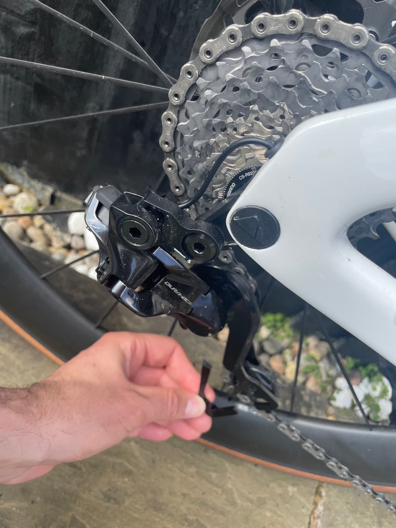

Dura Ace Jockey wheel fail on new Canyon
I mean, the photo isn’t taken before it broke so presumably it’s a result of the cage not being there any more… although if the chain fell off the jockey wheel that could also have broken the cage :thinking:
Could have been some random road debris getting caught up in chain/RD pully, but I’ve only seen that happen on MTB’s where there are more twigs/rocks flying around (and it’s still very rare/unlucky even for MTB’s). I would suspect an assembly/setup error of some kind, just hard to tell where the force was based on the pic. There should be very little load on that part when things are operating normally, so something abnormal happened to cause the break. Could have even been damaged/cracked in shipping and was just barely hanging on. I would check chain length, but typically OEM’s size their chains too long rather than too short. I’ve seen chains incorrectly routed through jockey wheels (basically running on the cage support rather than entirely on the wheels, but that should have left some wear marks where it was rubbing. A close inspection should tell a story of where the force came from to break that section off.
On the scratch, just move on. Banged up bikes with scratches and wear have been scientifically proven to be faster… Garage queen bikes are notably slower. It sucks that it happened the way it did, but scratches and wear are inevitable if you use your bikes as intended. Getting the first scratch “out of the way” is one less thing to worry about going forward.

I had this happen to me, as did a friend of mine. We both replaced the cage, which is relatively cheap, but still a pain in the ass. I was really disappointed in Shimano. This happened during COVID with my SL6, and parts were hard to come by. Ultimately, I replaced the RD with an Ultegra RD, which works just a well and has an alloy cage. Still have the DA RD, though. If I ever sell the bike, I’ll put the DA back on, but I think an Ultegra RD is the better way to go.

This exact thing happened to my Aeroad CFR last April, on my 2nd ride!
Canyon weren’t particularly helpful at the time, asking me to send the bike back and re-order a new one, with a 2 month wait. I just bought & fitted the replacement cage myself, but the damage to the chainstay does irk me.
