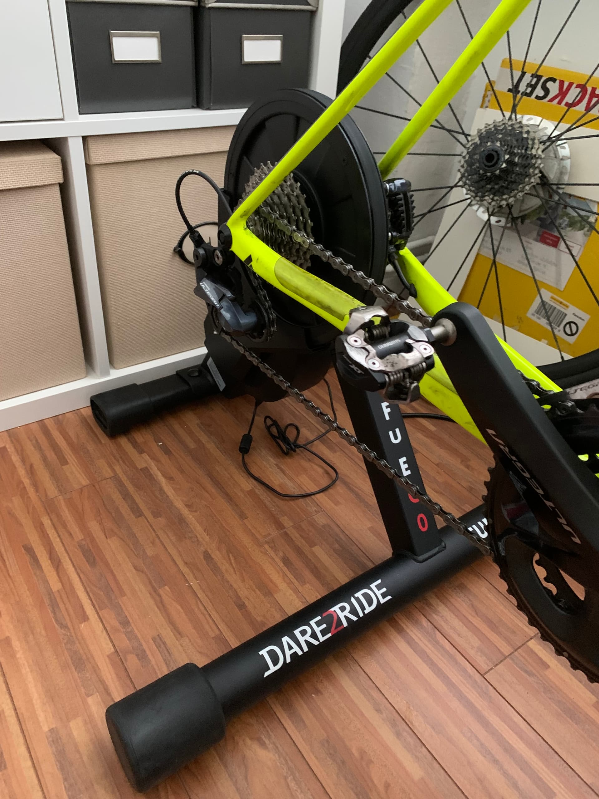

I’ve recently purchased one of these, cheap option to get going in pain cave.
First impressions aren’t great.
It did connect and display cadence on first ride, can’t connect it now though.
As spinning out at inclines 10%+ I carried out a firmware update (after many attempts), no cadence and although I never managed to get to a 10% incline on the Alpe to test it I can say on the KOM it didn’t inspire confidence. I’ll be testing it again tomorrow and if not happy it’s being returned, will have to get another Kickr although I’m loathed to as Wahoo have screwed me over on a warranty issue with another unit.
