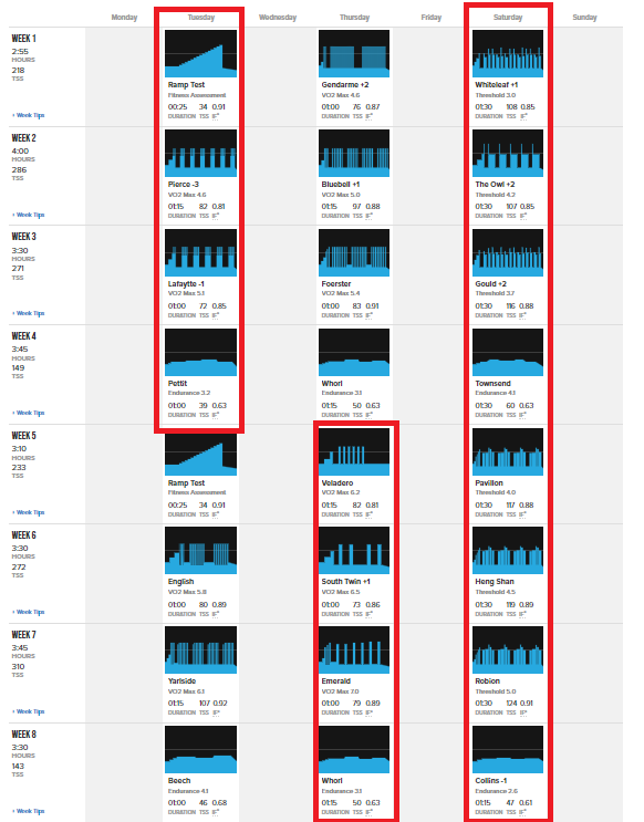

I think you can get what you need using Plan Builder - you can set it up with a low volume plan, and tell it that you don’t have any events.
If you put in that you’re training for Olympic XC racing (1-2 hours high intensity mountain biking) then it’ll give you 3 bike workouts a week, or if you put in Offroad Triathlon it’ll give you 2 bike workouts a week and you can replace swim/run workouts with crossfit… I’d like to say that using the tri plan would work better, as the bike planning should take into account the TSS from other workouts but I don’t think it quite works like that yet…
Others will know this better than me, but I believe that using Plan Builder like this will give you base/build cycles which should work better than just picking Sweet Spot Base as a plan, or selecting VO2/Threshold/Endurance workouts as you go along.
I would start with short power low vol I BUILD. I would do the Saturday workout for sure every week. On Tuesday of every week I’d decide whether I wanted to do the Tuesday or the Thursday workout for that week. Probably for the first four weeks I’d do the Tuesday workout & for the second four weeks I’d do the Thursday workout.
