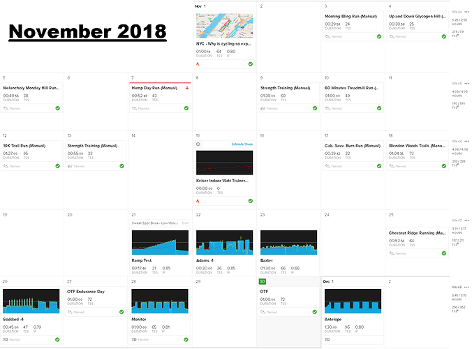

Anyone else doing CrossFit or Orange Theory Fitness, something along the lines of that with your TR sessions?
I just started this week and felt like Monitor last night was very difficult. I am debating in dialing the intensity back some for other rides. This week was first week back to any strength training / HIT, so it may just be the changes in my activities.
I’ve been adding the Runs and Workouts to my Calendar as well.
