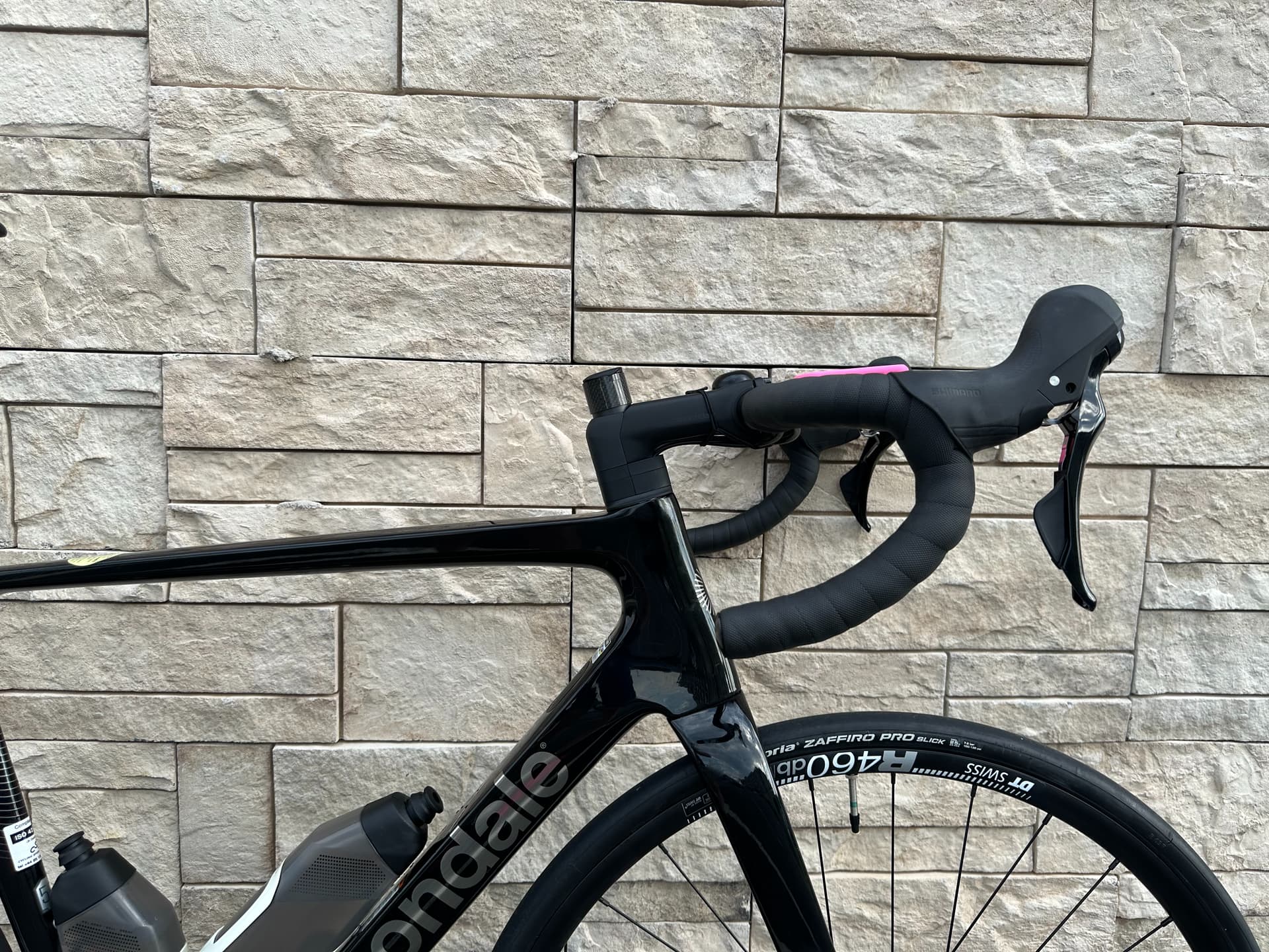

I love the bike. It’s very comfortable and feels quick. I have the Conceal stem with Enve aero handlebar. I don’t want an integrated bar/stem because I travel with it. I have the cables under the stem and they aren’t noticeable.
For me, adjusting the bars means cutting the fork. I think WW is the right place to ask about a chimney.

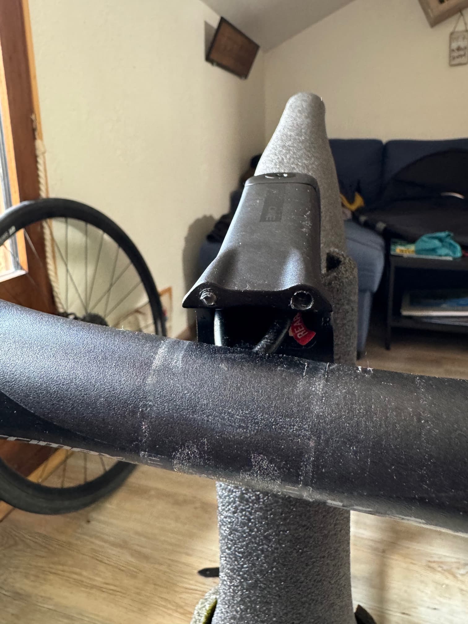

Hello All,
Brand new around and it follows the acquisition of a Cannondale SuperSix Evo… After more than 1.000km I am sold on it… However this is my first carbon, aero, disc brake bikes so a lots of new stuffs for me on the mechanical side.
I have an issue with the Stem. I m sharing 2 pictures for you to have a look.
So, I do have the original Stem - Looks like the C1 Conceal Stem.
when I was rebuilding it, one of the “screw” broke up with few millimetres staying out.
The questions I do have are:
  1. Do you think I can take it out and just replace the screw? - If yes, what would be your method?
  2. If I do replace the Stem, I need to take out the cable and so on - Due to that, I will have reset the Hydraulic system for the brake, and reset all the cable? Basically a big mess.
  3. In my opinion, a screw breaking on that place, would be a Quality issue from the factory. With your experience, could it be my fault when I mounted the stem back?
Thanks !
It will depend on why it broke. You’ll need to assess the integrity of the threads once you have the bolt removed. As long as you can get a new bolt to fully seat, you should be OK.
There are bolt removal tools that you can use to extract the snapped bolt.
Yes, you will need to disconnect and then re-bleed the brakes. This is the downside of integrated cockpits. But as long as you can get a new bolt to seat properly, you’ll be good with the original stem.
It could be your fault if you over-tightened it and did not use grease on the bolt. When dealing with bolts on carbon stems, always use a torque wrench. Then ensure you are using the proper setting (usually. ~5nm for stem bolts).
Thanks, for the insights. Will look at the tools and try to get it out before getting into some new territories with bleeding the brake and avoid the big mess.
I used a Torque Wrench and you’re correct, it is 5nm for stem bolts. My thoughts were it might have not been properly straight and put some tension in the screw.
If it is cross threaded, then you will definitely need a new stem. Check it carefully.
I did little by little to hold and then tighten it later on. Maybe too late and my thoughts were that the screw would lightly “bend” and break. My feeling was it kinda broke net like a chisel on a rock.
Will investigate, this week after cleaning the bike and taking it out from the box and will keep you posted.
Thanks for your message :slight_smile:
