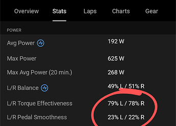

Can you share your talk effectiveness and pedal smoothness stats too? I’ve found them useful to diagnose faulty pedals in the past… if the stats from your left pedal are lower than the right then it could indicate you are experiencing intermittent dropouts from that sensor.

I don’t seem to have that data recorded. I use a Garmin 1030+ bike computer but maybe I don’t have it enabled? I’ll have to look into this a bit more.

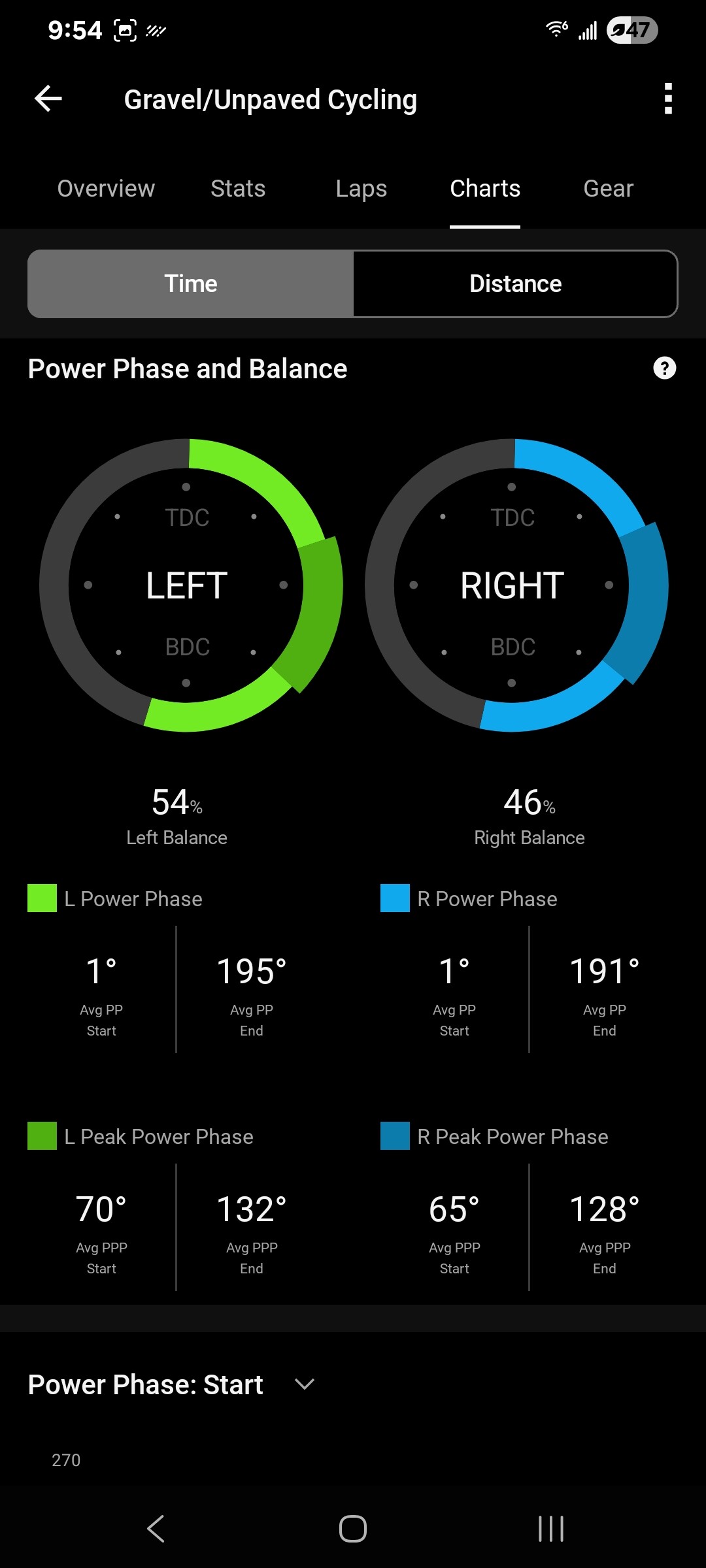

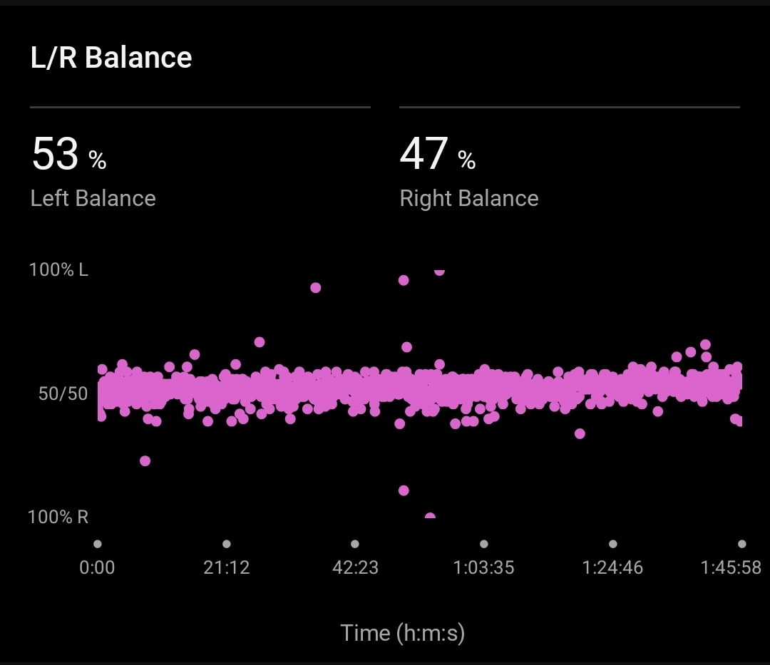

First 2 screenshots are from last September with SPD bodies (same that I had on for ~1.5 years at that point)

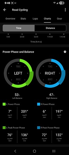

Here’s the 7/21/25 ride with road pedal bodies…

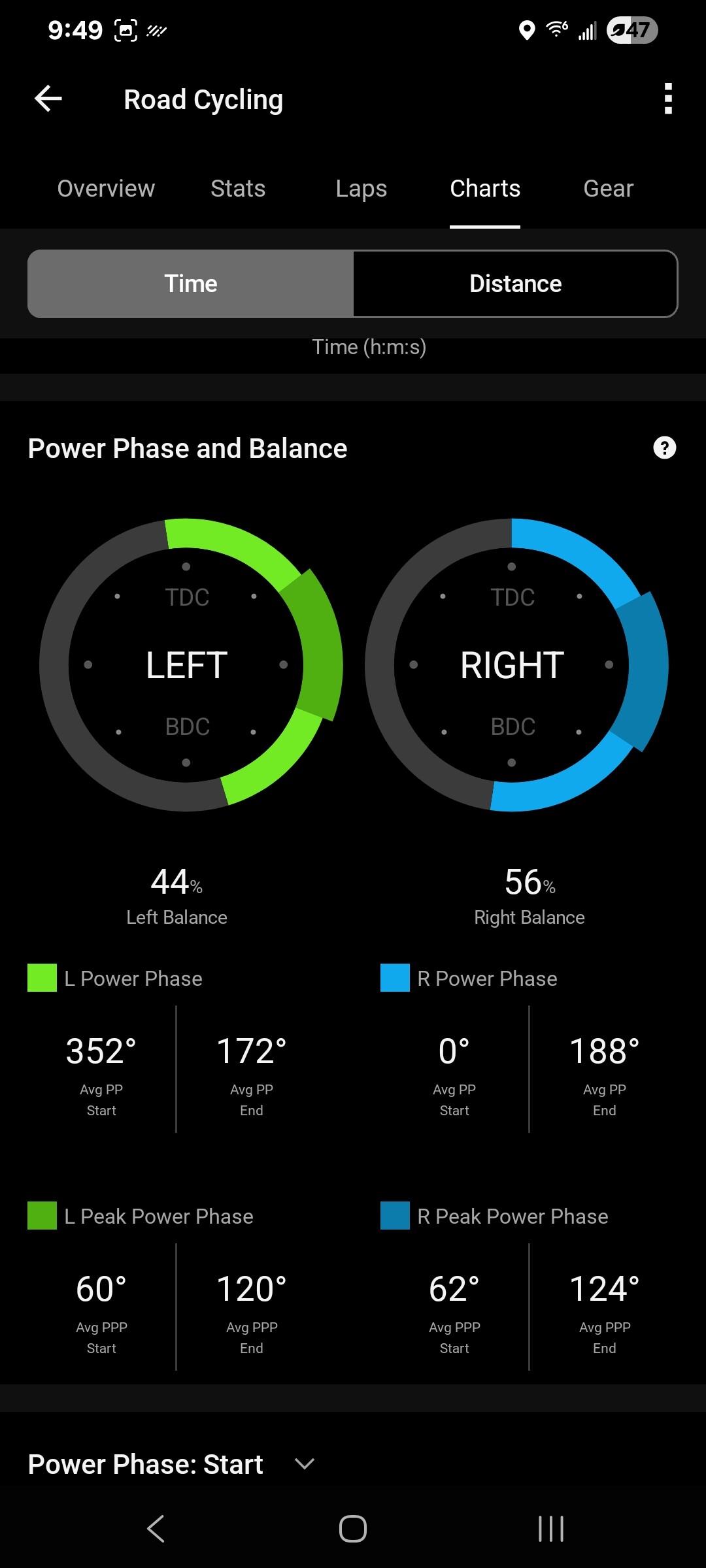

And here’s yesterday’s ride with SPD bodies. Looking back through the past few weeks with this set up, it looks like the left power phase is consistently earlier in the pedal stroke (chart looks rotated counter clockwise)
I appreciate your help with this stuff! Not sure what to make of these. Rides were all on the same bike, just different shoes but got shorter cranks in Feb this year (175mm→170mm)
Nothing looks wrong with any of that to be honest :thinking:

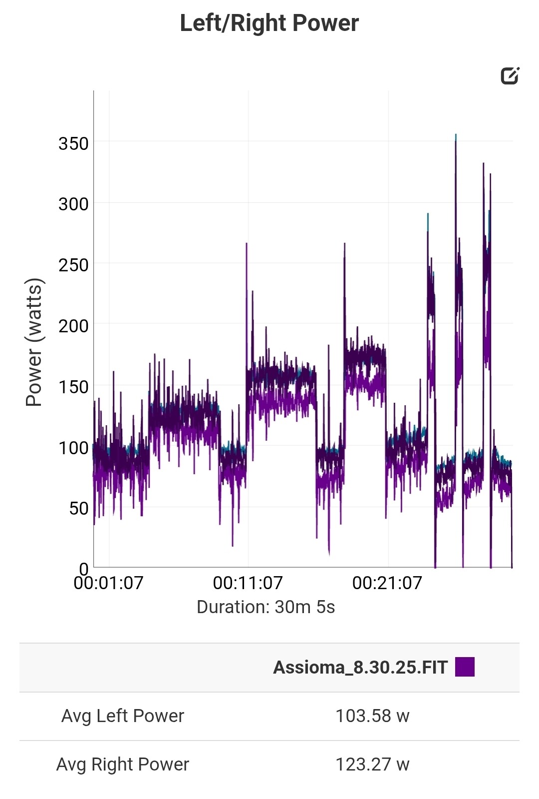

Tested against my Kickr Core today and the Assiomas were way low. They always used to line up really well with my Kickr :melting_face: I’m out of warranty too (even if I didn’t tell them about the SPD bodies :eyes:)
Assiomas are ~10% low at Z2, ~6% at threshold, and ~15% lower in the 30 second sprints.
I could scale the left pedal so the total power lines up with the Kickr and that would get me to 51%L/49%R but then I would never really trust any PBs.
