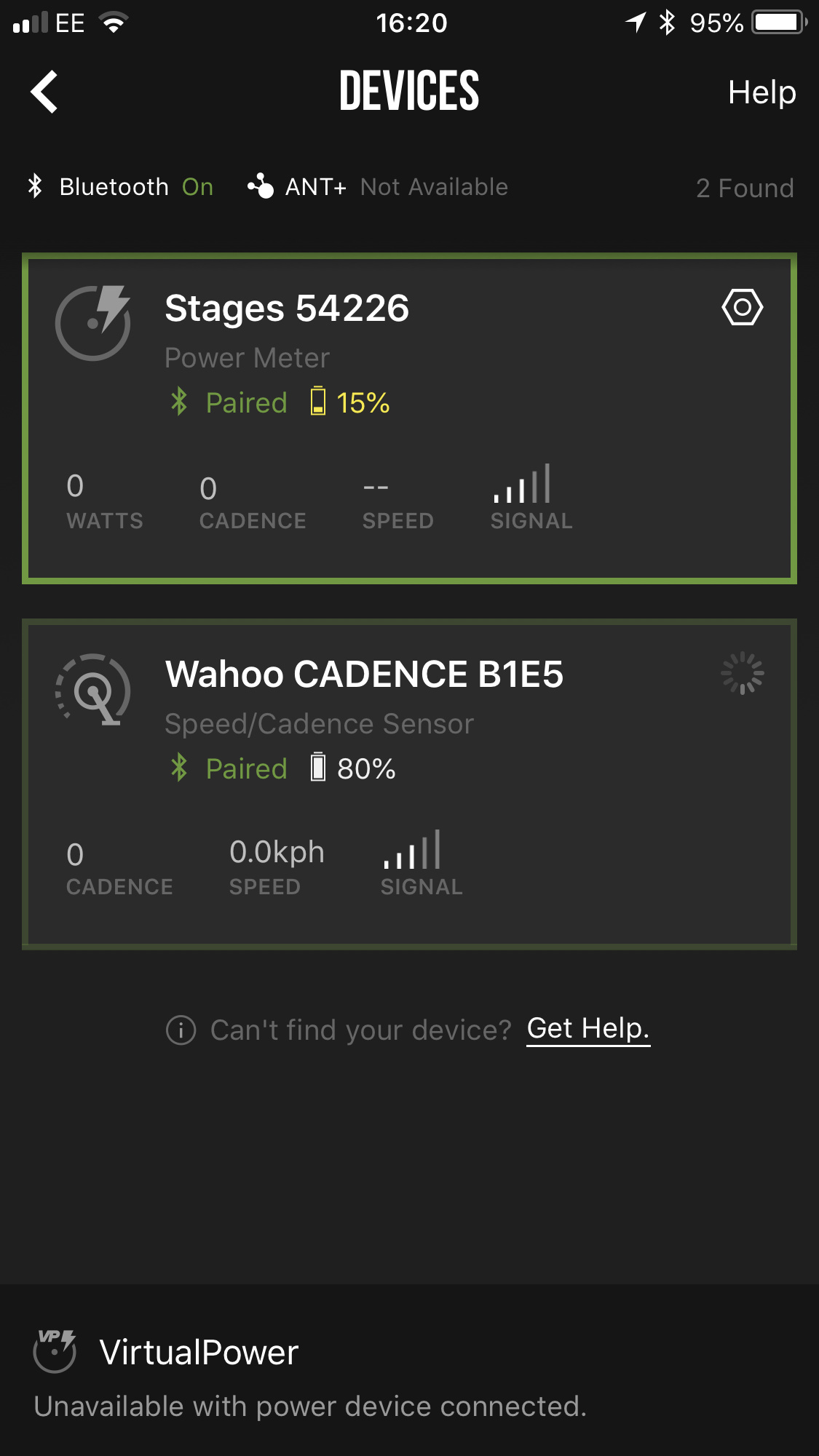

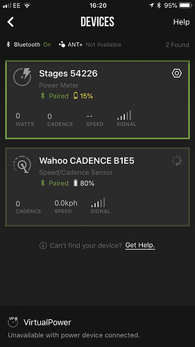

Battery level for Stages power meter different on TRapp compared with stages app

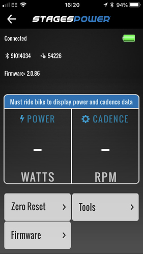

My L crank Stages power meter had a low battery level reading on the TR app, but the Stages App suggests power is good?
ANy ideas what’s going on?

In your situation above, I’d go with the TR 15%.

I’ve put a new battery in and both stages and TR apps are reading 100% now…
Doesn’t matter that much, tend to put in a new battery every so often anyway, but it would be nice to understand what’s going on, given that the apps can measure watts/Calibrate without any difference.
