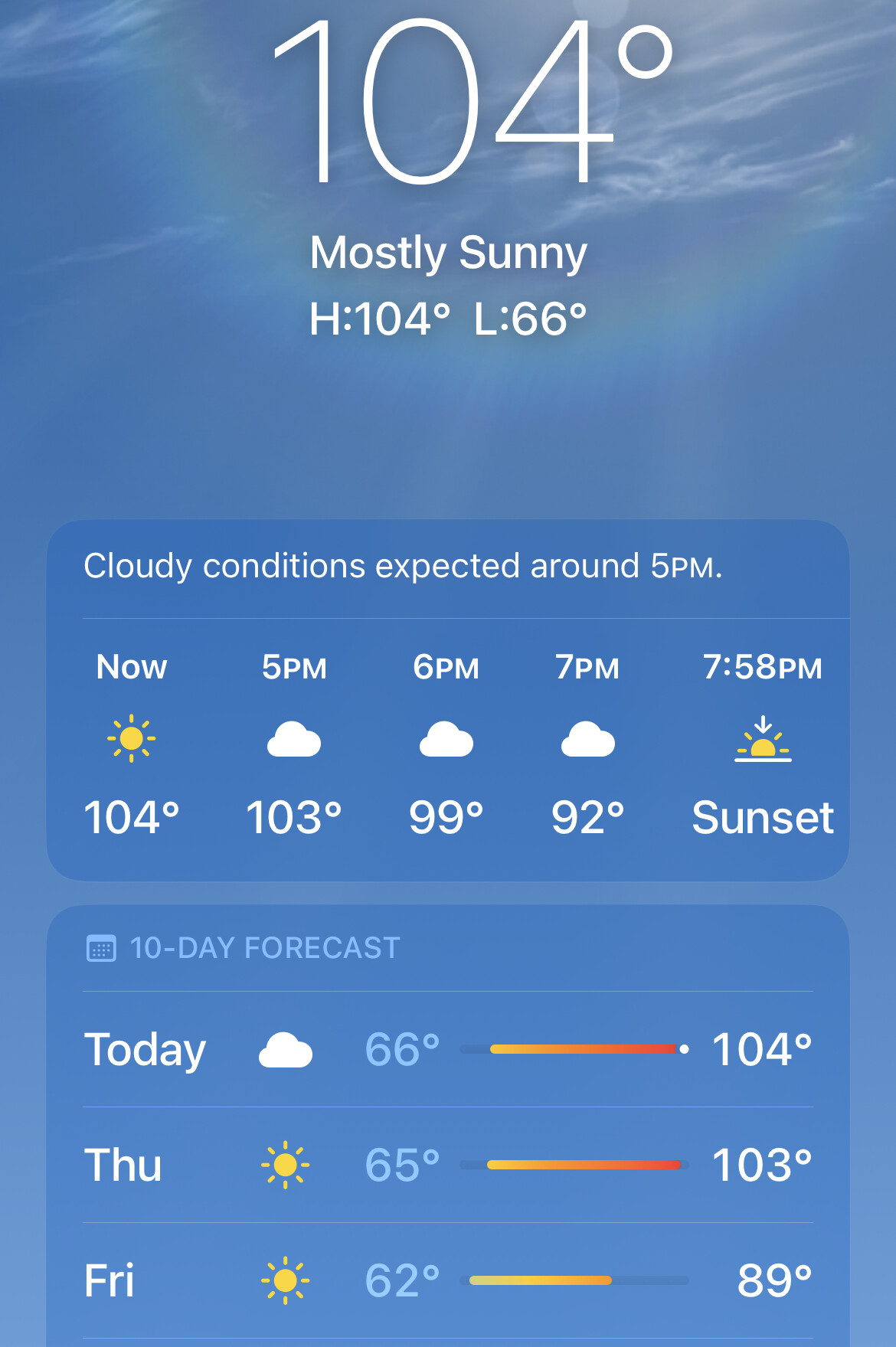

My off-season is coming to an end, since we can ride all year I scale back during the hottest months of the year.
