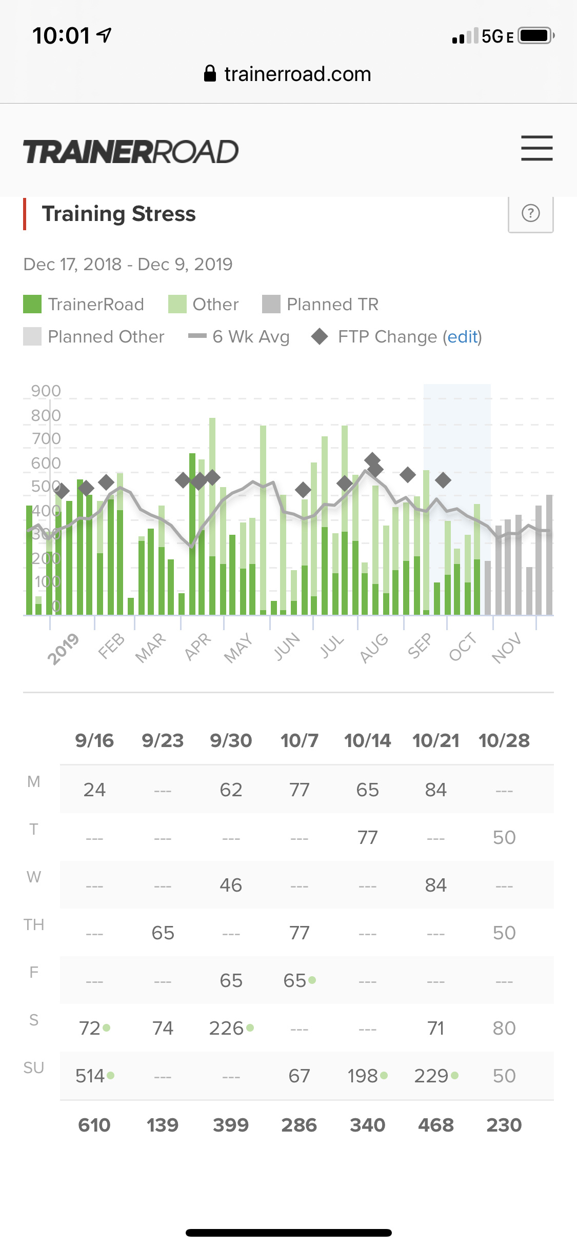

I understand, I think you’re right, I did some math last week, in the last two years I’ve done an average of 11/12 hours of training weekly.
I’m sending down the tss bar of the two years I’m training.
but to fit the race correctly, I can only make one of the TB 1/2/3.
because with the weeks I will not be able to close the planned.
