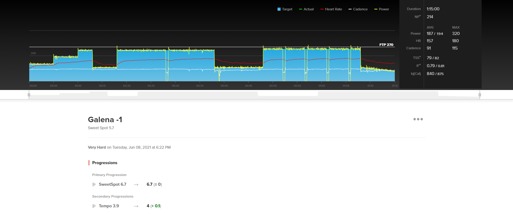

I wonder when I will ever get a failed workout survey. I have been really sick for the past 7 days and intentionally took 4 x 30 sec breaks in the second interval of comeback ride of Galena -1 (‘Achievable’ for me) because I was dying yet it qualifies as a pass (I marked it as ‘Very Hard’). I was hoping that my upcoming workouts would be adapted to become easier but a alas, the Sunday workout got adapted to be harder.

It’s actually quite lenient with what it considers a pass. I’ve skipped an entire 1 minute interval of Baird and gotten a pass survey before. As far as I’m concerned, I think that means we put way more pressure on ourselves in these workouts than we need to.
I would still say what you did falls into a pass, but maybe falls into the Struggle Pass category that they mentioned in the first podcast. Let us know if that Sunday workout adapts again. that’s still a ways out with a handful of workouts ahead of you, so it is possible it gets adapated again before Sunday. I wouldn’t worry about it until after Saturday’s workout if it hasn’t changed and it feels undoable.

The upcoming workouts I am pretty sure I will not even 80% pass after todays experience (Truchas +2 and Warlow) so there is hope that the adaptations that I think I need still happen. Although, who knows, maybe I will be able to do them after all.
