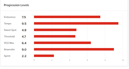

So I’ve just got this and not sure what it really means apart from the fact that Tempo and Anaerobic workouts are going to be really hard.
Theoretically, in some cases some of your levels might go to 1.0 after an FTP increase, but it always depends on what your level was before the Ramp Test and how significantly your FTP changes. There’s never a situation in which levels should arbitrarily default to 1.0. Additionally, how levels respond to FTP changes is a point of continued refinement.

Progression Levels will now decrease in proportion to the FTP increase. It is in PROPORTION so going down to 1 is clearly a bug, don’t worry that much it will be fixed if not it has been already done.
