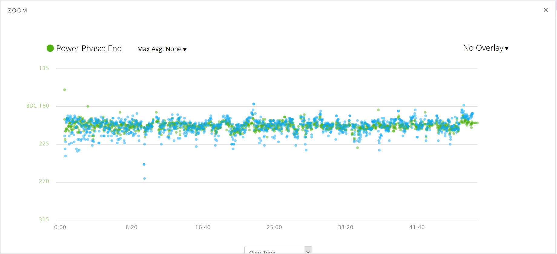

I don’t appear to have any issues with cycling dynamics recorded from my Garmin Forerunner 945 based on just my “Power Phase: End” chart from the Garmin Connect browser view.

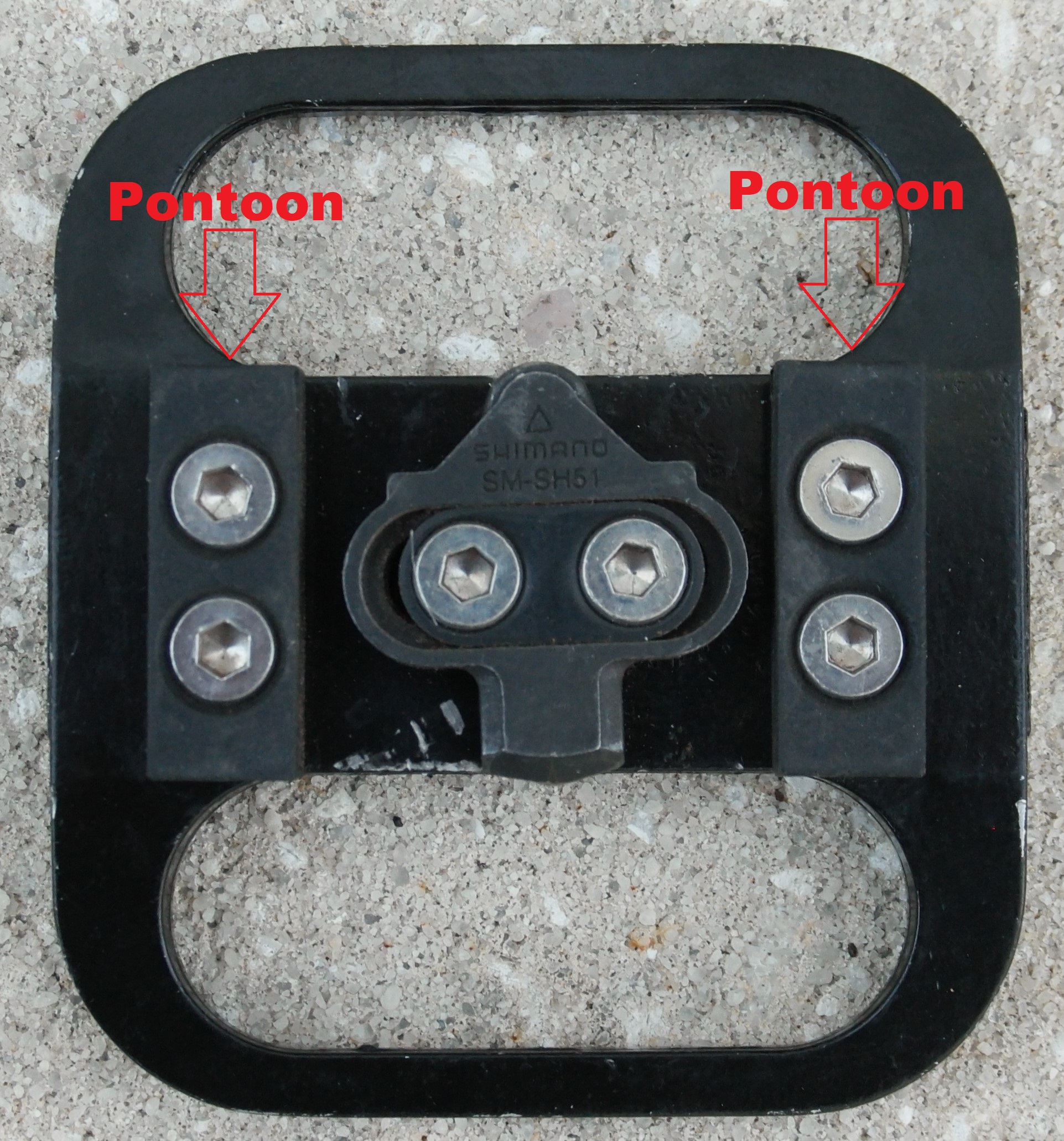

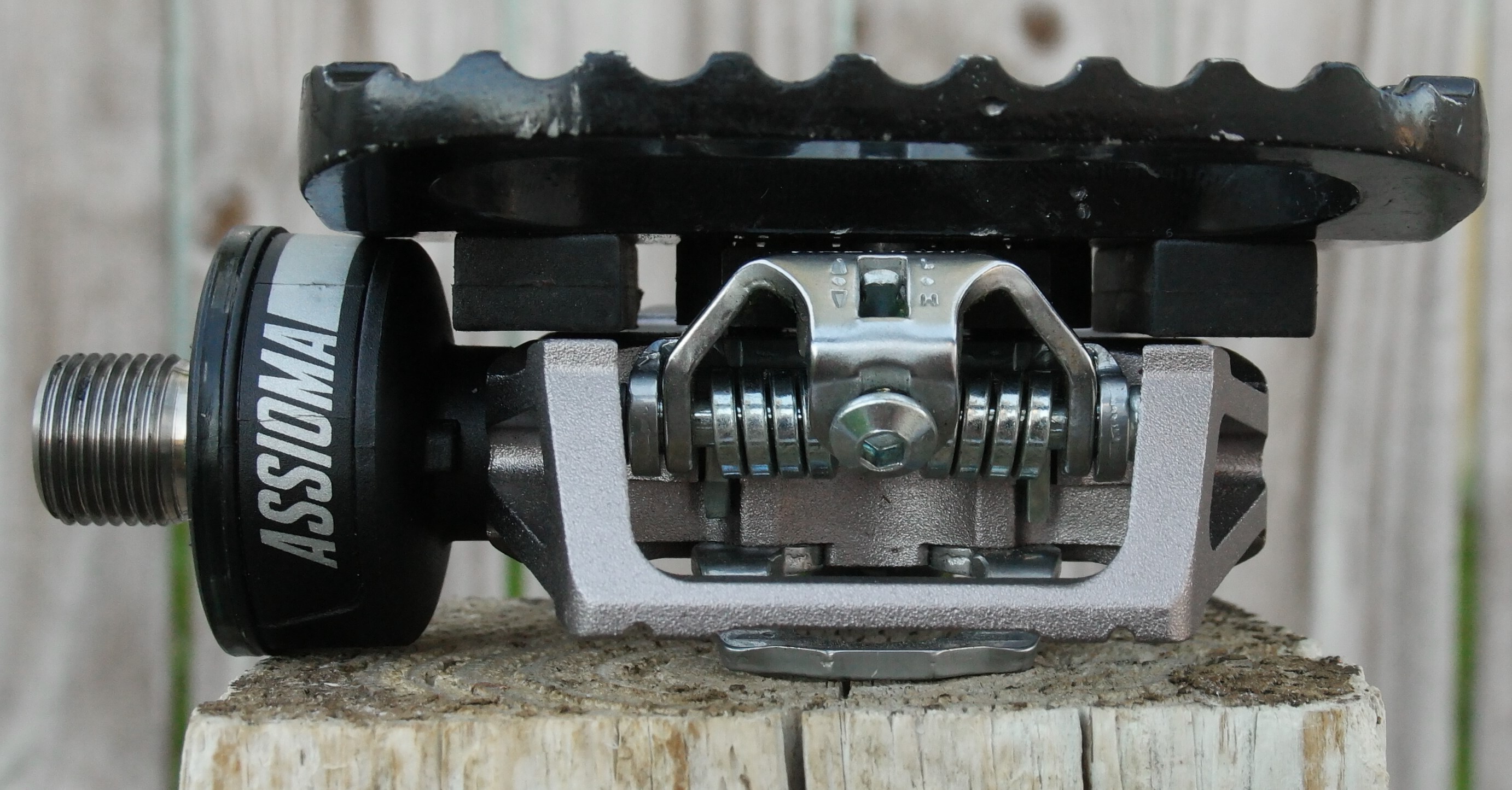

Since I have a set of Winwood platform adapters that I bought some time ago, I thought I’d try them out. Short answer - I wouldn’t use them. At least not on the Xpedo Baldwins. The ‘pontoons’ (hard plastic) on the bottom of the platform don’t allow for release from the pedal because a pontoon contacts the Favero Assioma pod in attempting to release the platform from the pedal using a sideways rotation. At least with Shimano SM-SH51 cleats. The only way that I was able to remove the platform from the pedal was by prying the forward cleat retainer away from the cleat. The platform would also have to be clearanced for the Favero Assioma pod as it’s just touching the pod.

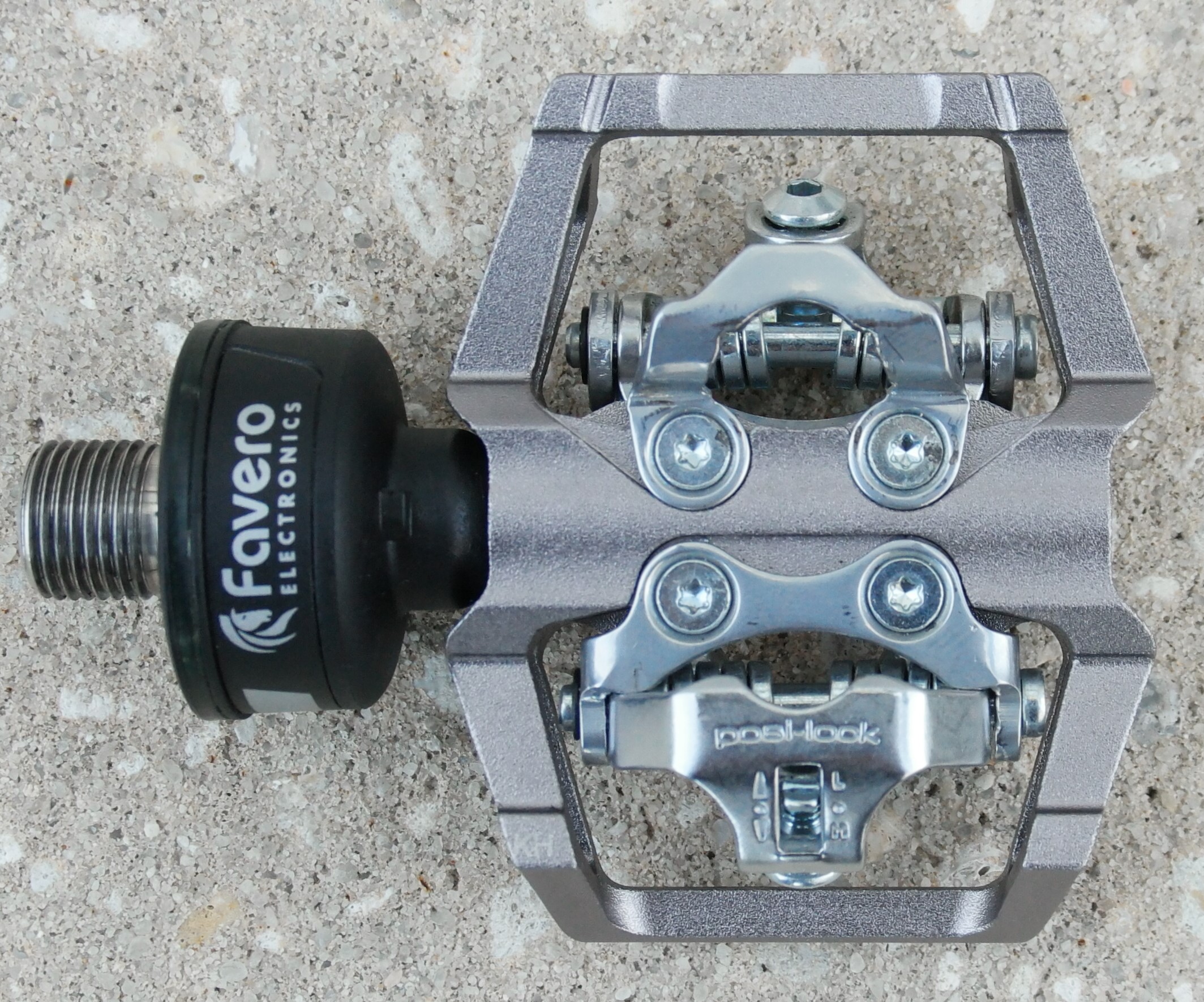

I originally never provided a top view of the Favero Assiomas mounted in the Xpedo Baldwins so here it is:

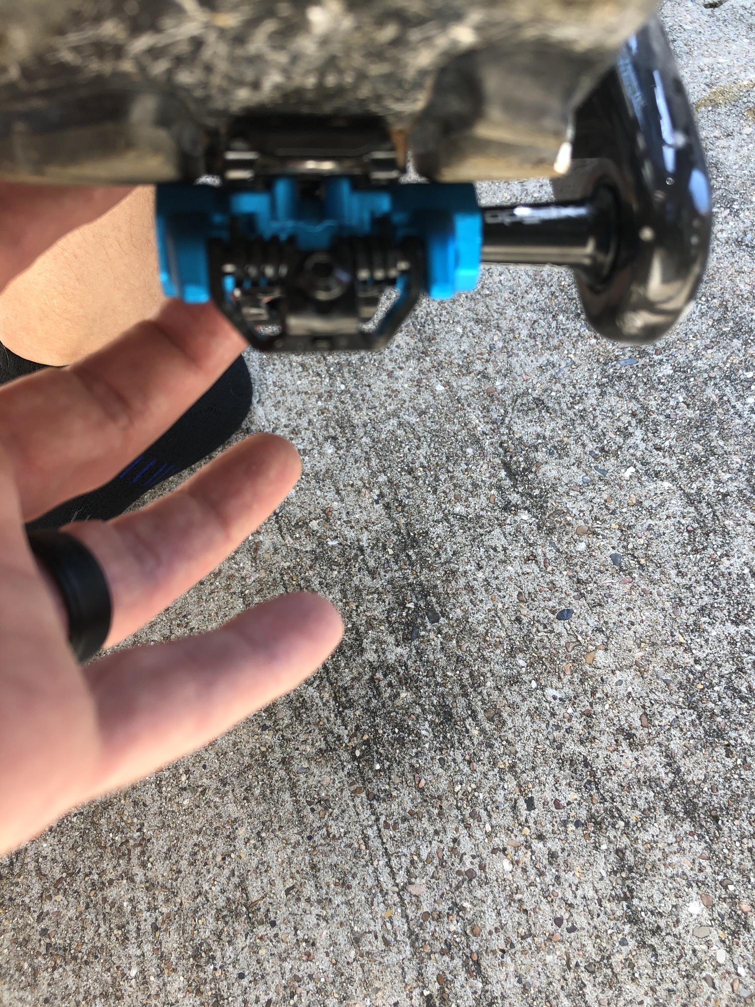

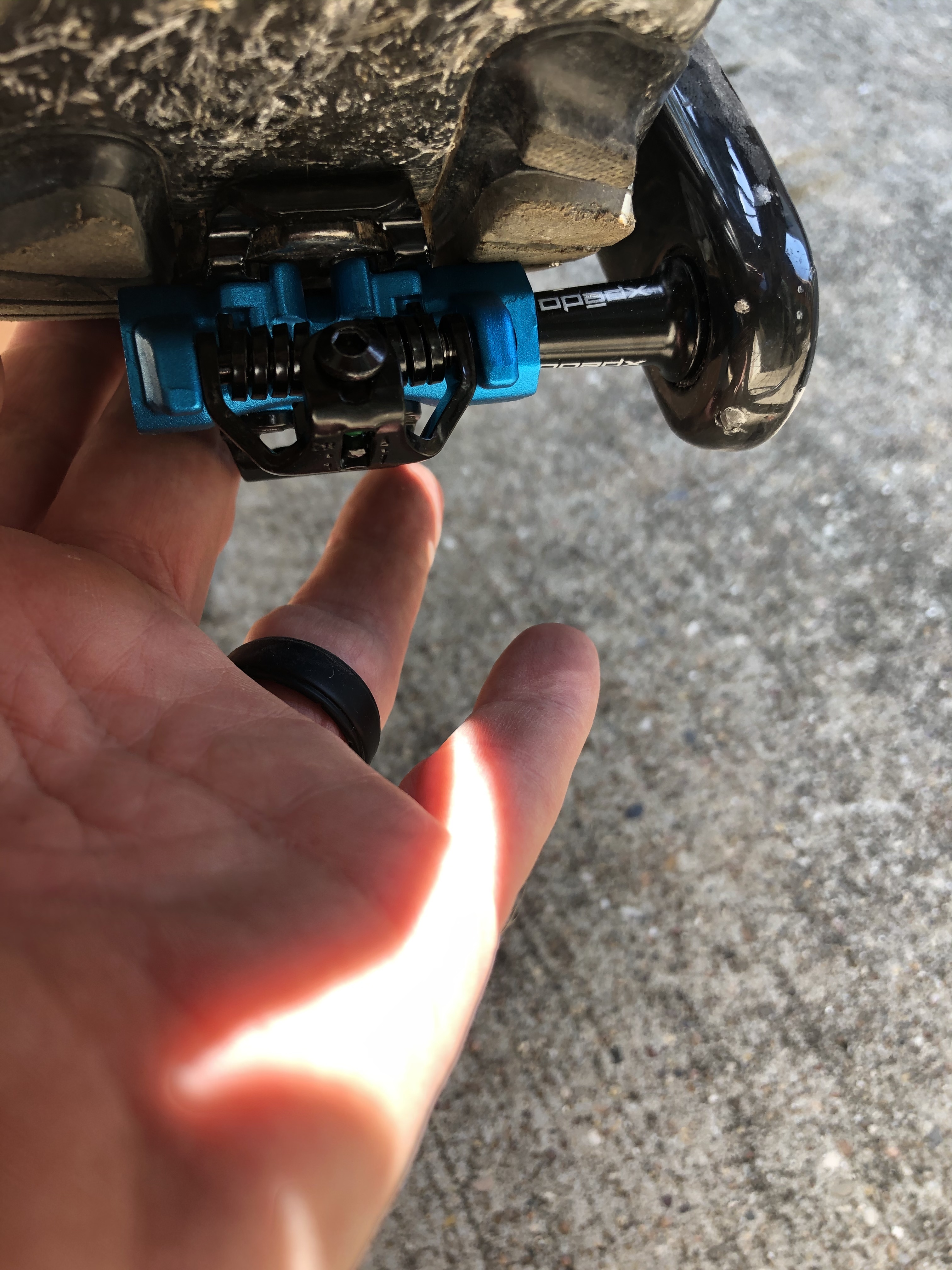

I’m using the Shimano RX8 (size 41) shoes and it clears the pods with a nice gap, no need to shave the sole. However, it could be because my cleats are positioned to the inside of my foot (?) I can see being a bit problematic if your cleats are on the outside, or if you have a wider foot.

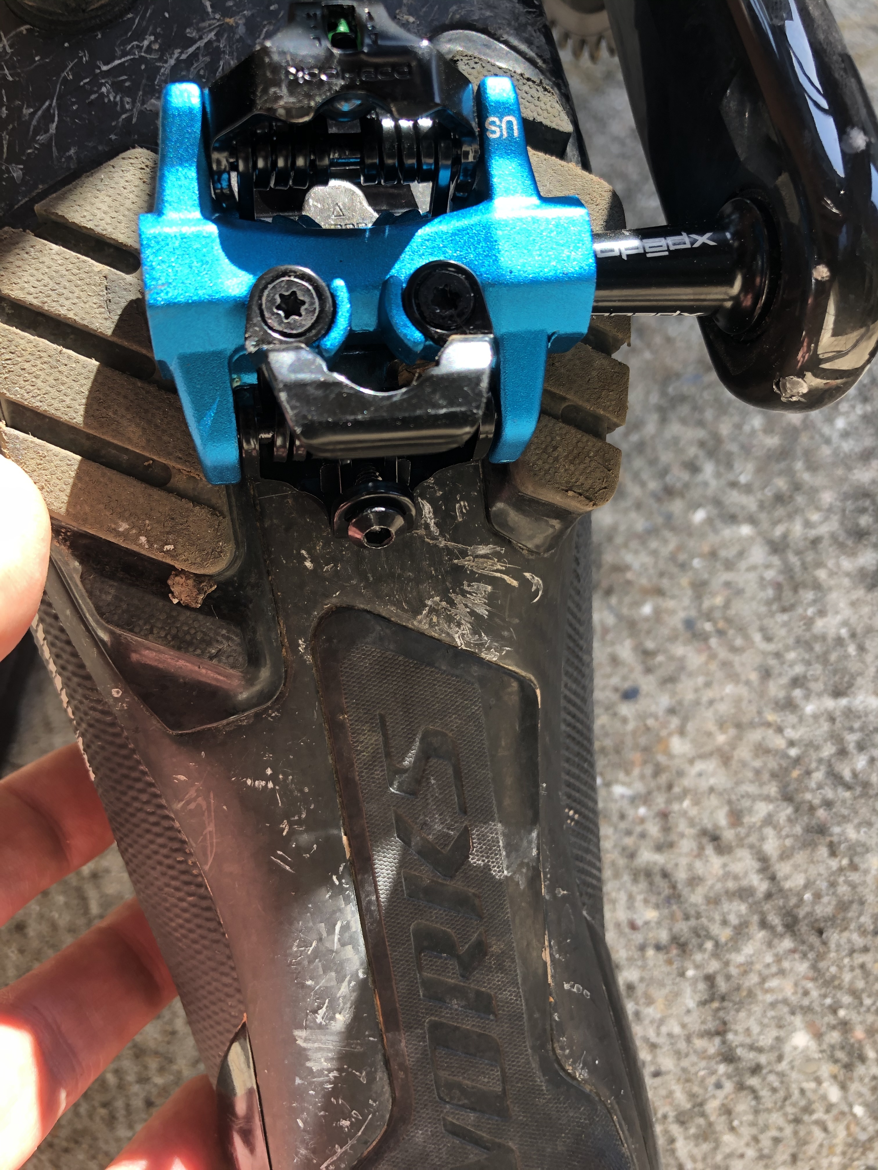

Now…I have really expensive S-Works Recon shoes and size 49 feet, so I’m really worried about having to cut them or them not working with the Assioma spindle. Can anyone who’s done this give me their thoughts on clearance and if I should order the Assiomas? Thanks in advance for your advice!!
image image
Update. Went out for 4+ hours of gravel on them yesterday. Easy clip in and out. Did notice a bit of a hot spot appearing after some extended periods out of the saddle, but I’m sure that just the platform size, not specific to the pedal itself.
Really tired of guesstimating TSS based on heart rate. Would appreciate any feedback on how you think these shoes will fit with the Assioma unit.
I think you might have to trim a little off the edge of the sole, but not a huge chunk. You might even be ok while riding and will only need to trim the shoe to clip out.
Thanks! That’s encouraging. Guess I’d better order a dremel too.
