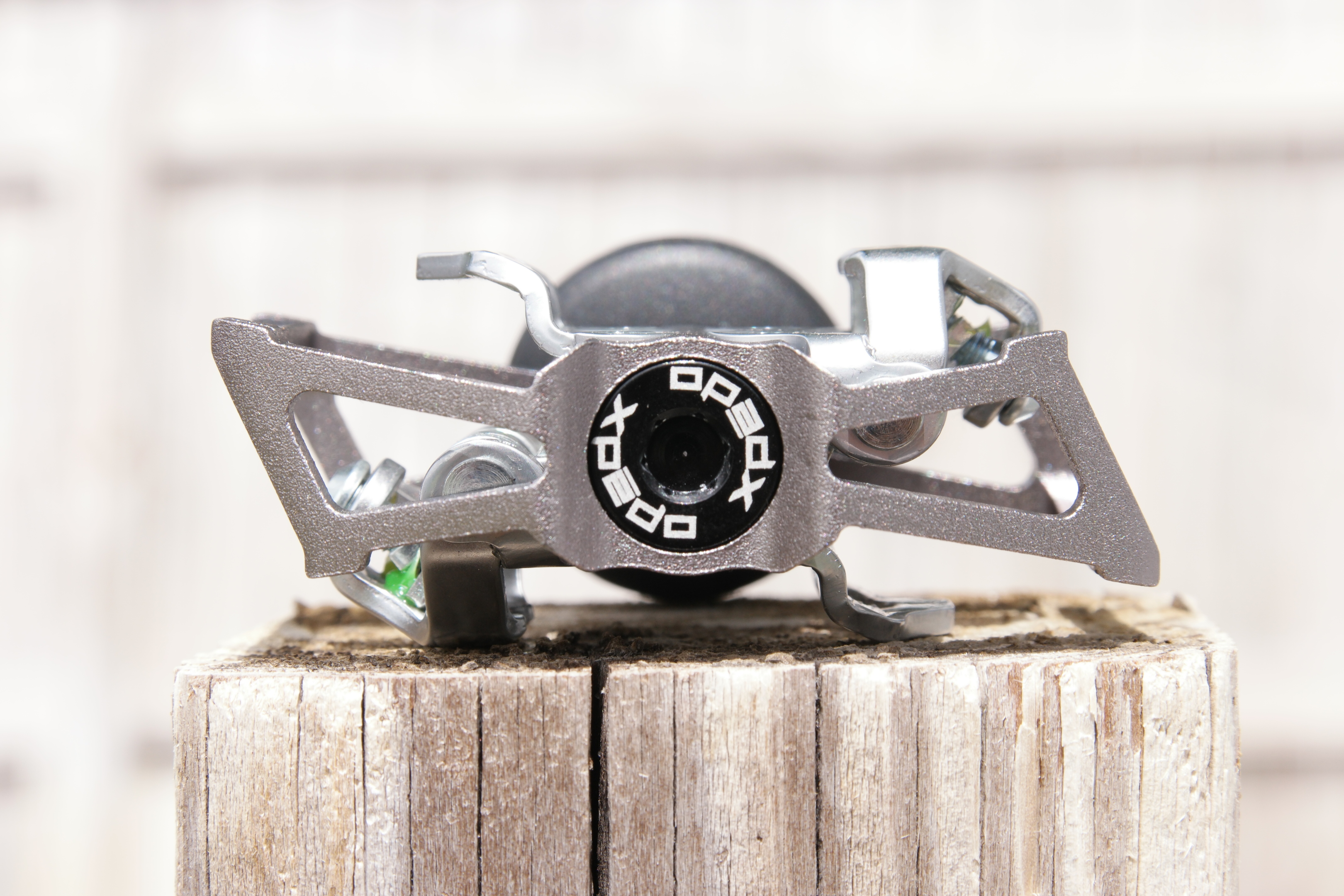

Xpedo’s site, TITANIUM SPINDLE KIT – XPEDO, lists the titanium spindle (axle) kit as fitting the “… M-Force 8, Baldwin and CXR …” pedals as confirmation of fit.
I’ve successfully installed the Favero Assioma power meter pedal axles on Xpedo Baldwin pedal bodies. Haven’t tested them yet. And I did have an issue with binding but determined that it was due to the outer bushing/bearing on the Xpedo Baldwin pedals. I compared the function of the outer bushing/bearing & found out that the Favero’s were fine but the Baldwin’s were notchety. Will eventually order a bushing/bearing kit but for now I’ve applied red Loctite & then tightened until binding occurred & then backed off until smooth again. There’s no lateral play in the pedal axle with this adjustment.
I also tried swapping out the inner pedal axle combi washer/o-ring & the Favero axle still bound in the Xpedo Baldwin pedal. FWIW, the original Baldwin axles with their original combi washers/o-rings have no binding in the Favero pedal bodies.

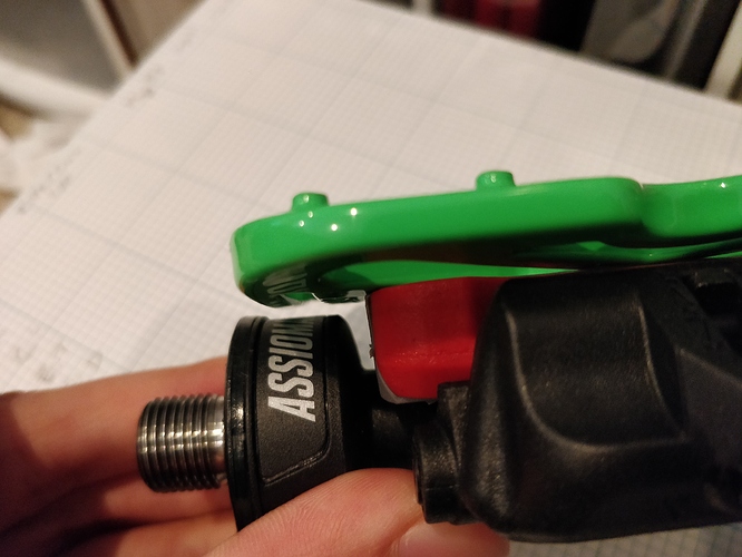

Do you have a picture of the Baldwin on the Assiomas? Curious if it could be used as flat pedals without SPDs, or if the pod would be too intrusive.
M-Force 8’s spacer/o-ring I got was 4.05mm thick.
Tried on Assiomas, and it binded.
Realized it was pressed onto the Xpedo axle by about 1mm; I compared to the other pedal that I hadn’t tapped the spacer out of yet. If I just put it back the spacer on the Xpedo axle, the bearings would bind, so the ~1mm press fit was necessary.
The Assioma axle’s shelf is a bigger diameter than the Xpedo axle’s shelf, so it probably can’t be pressed further.
I got some 500 grit sandpaper, and sanded in alternating circular motions and rotating the spacer every few seconds to keep it flat and even. 3.75mm thick would still bind when tightening to 4Nm for my pedals. Went further down to 3.65mm, and now it’s smooth, and can’t feel any play! Took about 5-10minutes of sanding per washer. Other side wasn’t as smooth, so I went down to 3.61mm, but I think that was just the bearings themselves as it stayed the same.

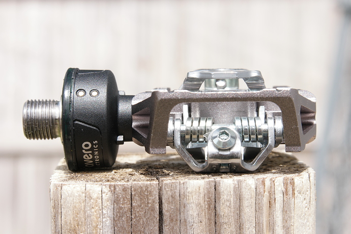

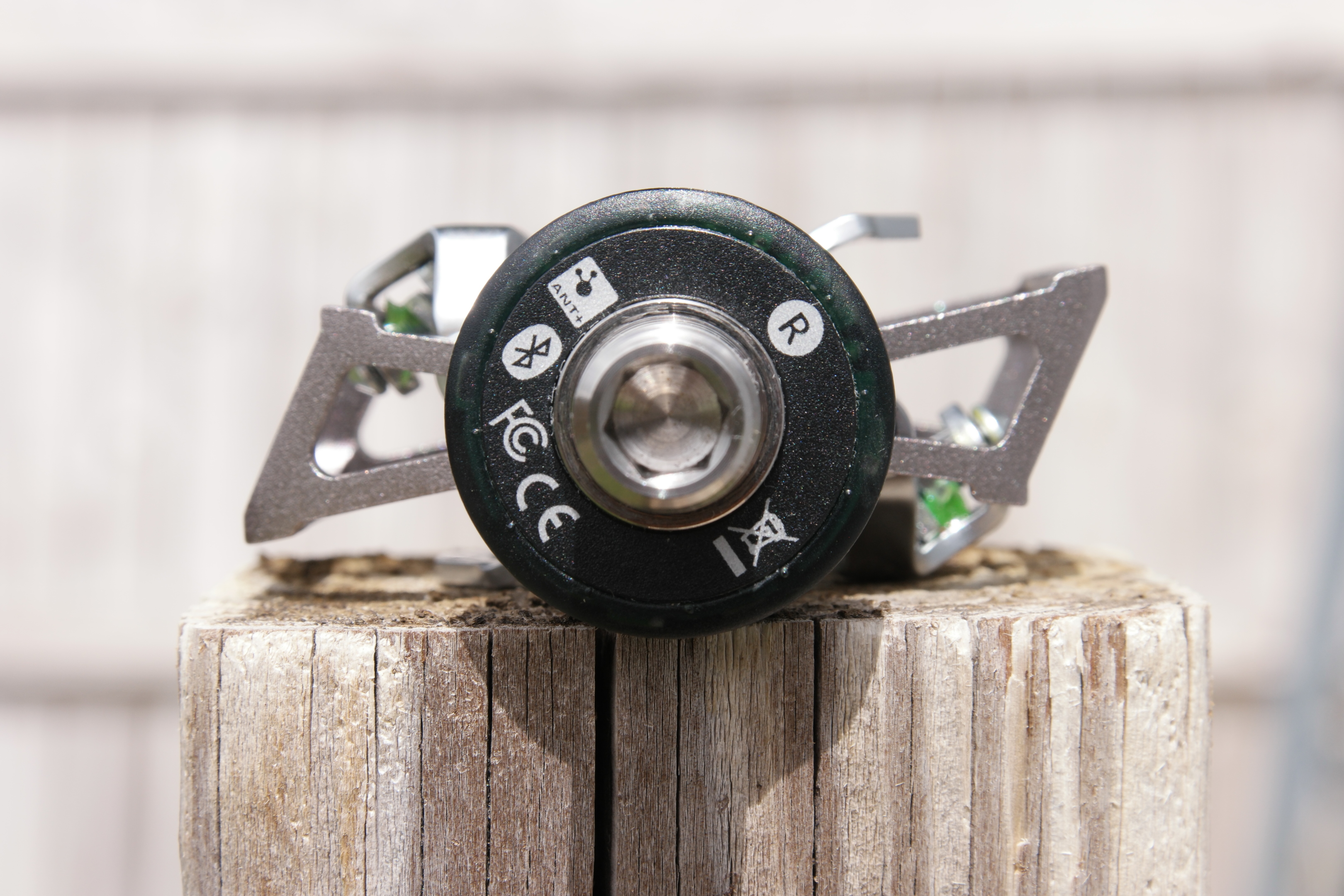

Here are three pics of the Favero Assioma axles mounted in the Xpedo Baldwin pedal bodies:
Don’t think I’d use them as flat pedals by themselves but I’d try them with SPD platform adapters. Those might be enuf to clear the Favero Assioma power pods.
Thanks for the pictures. I agree flat shoes on those wouldn’t be good.
Before I got my Xpedo bodies, I used Flypedal V2 platform adaptors on the road bodies. Clear the pod fine, but I filed them a bit just in case there was any flex.
I wish I could use the flat adaptors on the SPD bodies, but since there is no rubber tread, all the force goes through the cleat. The metal on metal seems like bad idea and wasn’t designed for load to go through that way, as iamholland mentioned a few post earlier as well.
The metal on metal contact wouldn’t be an issue for me. The plastic alternative is too subject to damage &, potentially, flex - so my preference would be a metal SPD platform adapter. And that’s exactly what I have. Only it’s no longer made but is similar in design to the one I linked to.

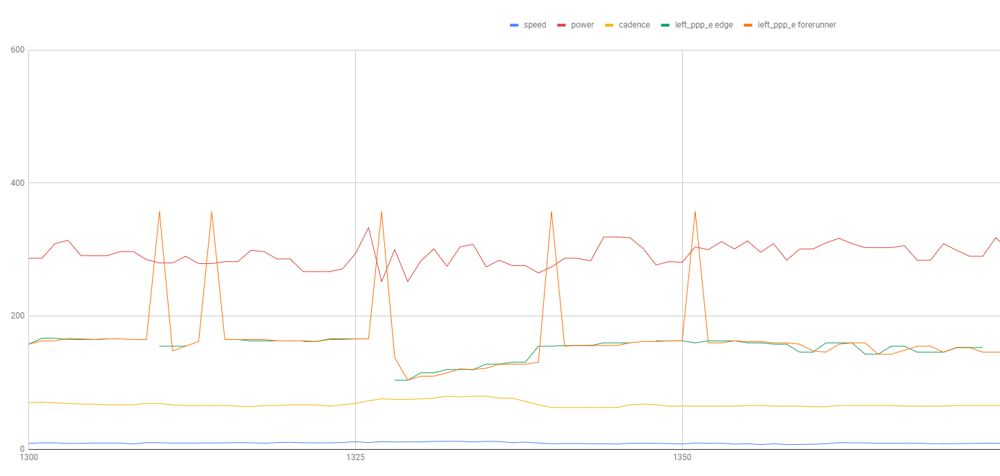

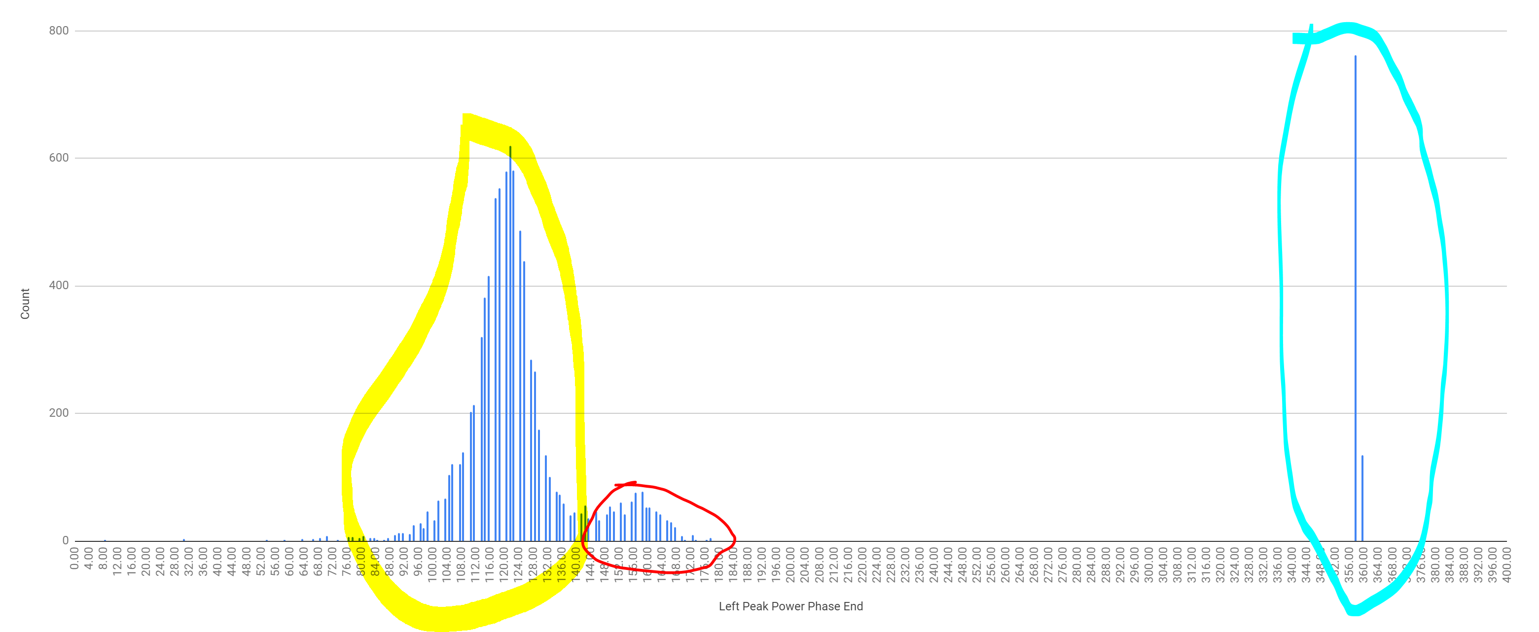

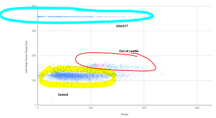

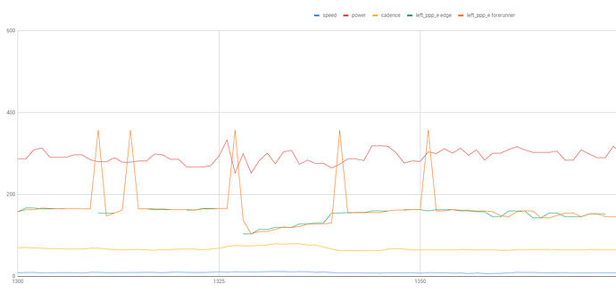

Anyone have issues with Cycling Dynamics?
I record with a Garmin Forerunner 945. There are a bunch of glitches for peak power phase values.
If I ride on smooth pavement, etc, I can get it to not report the glitches.
But normal riding, and especially gravel, the glitches are all over the place.
The averages get thrown way off with these glitches.
If I dual record with the Garmin Edge 520, the glitches aren’t there. But, Edge 520 isn’t officially supported and won’t receive the metrics without the forerunner also running…
I checked data from before I got SPD pedal bodies, and the same issue was there.
Anyone else also record Cycling Dynamics?
