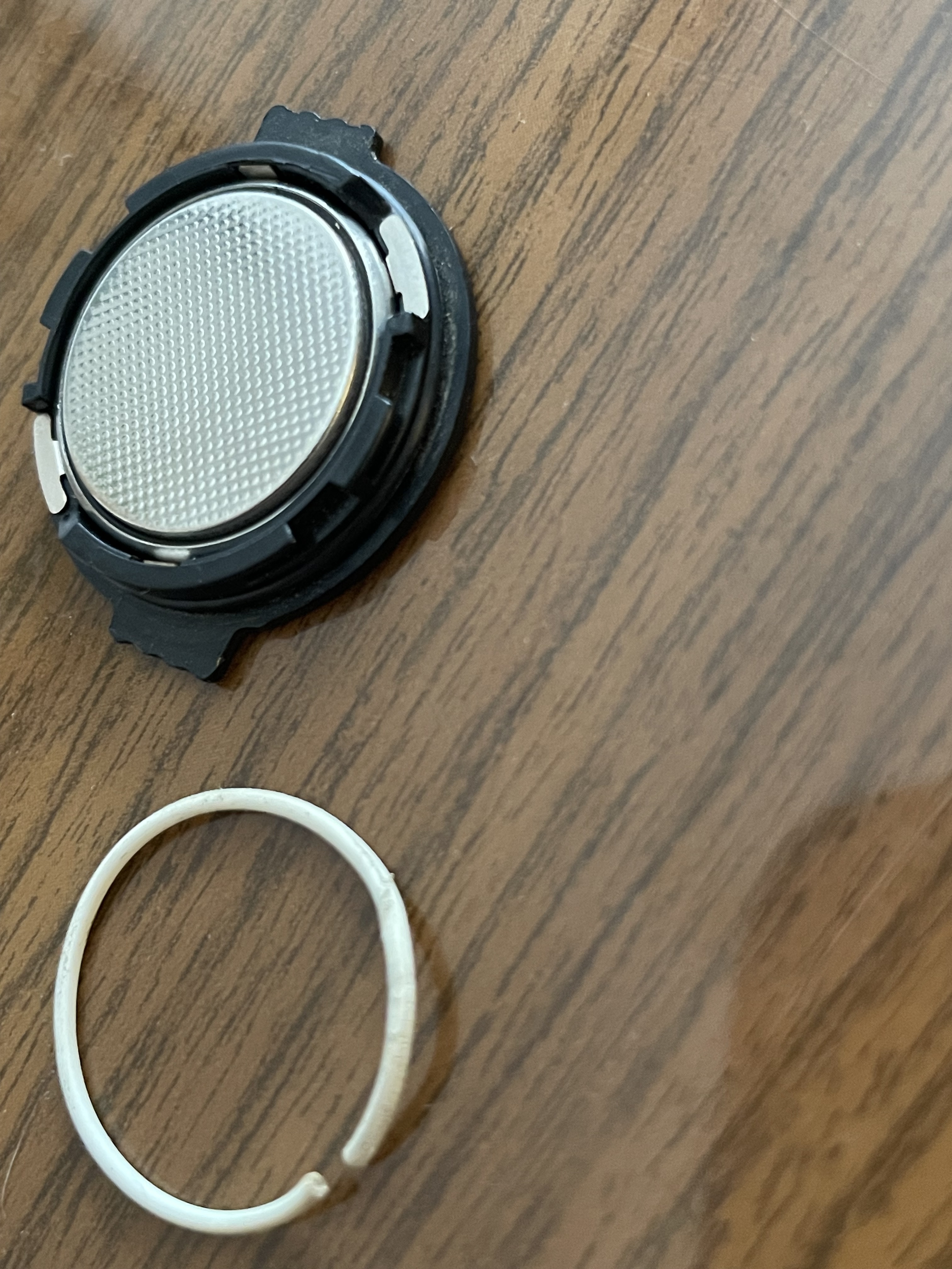

Hi all,
I just noticed that the white o-ring sealing the battery cap (precision gen2(?)) is broken.
I am unable to find a replacement available (EU) - only the full cap which is kinda expensive (10+€). Any hint /ideas where to find or an alternate which also fits?

Damn - maybe I’ll get into the weeds and try to estimate the size and shop for some generic ones. The original one is torn so I’ll get only a rough house number when I try to measure it anyway…
I got a reply from the 4iiii support: The dimensions are 1 x 17 mm. So I’ll look for a generic one in a hardware store.

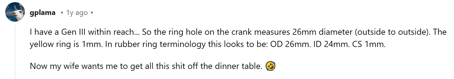

For Stages, gplama posted on another forum:
