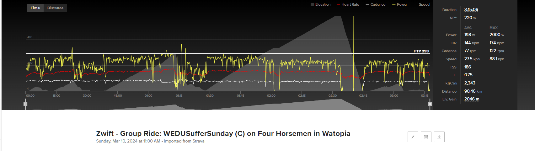

Four Horsemen, huh? Here’s my graph for that. 254 TSS! :joy:
If you have the corresponding screenshot for your ride … please share with the group. :wink::sunglasses:
Hopefully you didn’t start dying a thousand deaths a third of the way up AduZ. As you can clearly see, I did. :grimacing::rofl:

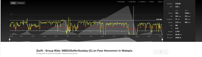

Here you go! I joined this group ride after a week packed with three intense workouts, right after a solid anaerobic session. I opted for the C group since that’s where I knew I could hang without feeling totally wiped out, haha! For the first part of the Alpe, I tried to keep it steady with a mix of tempo and sweetspot. I wanted to keep the intensity low, aiming for a yellow day the next day. So, I cruised through the rest of the climb, sticking to zone 2. Managed to finish the entire route in about 3 hours and 15 minutes.
The next day was rough, to say the least. I struggled to get out of bed, feeling sore all over from the previous week’s efforts. It hit me hard, and I had to take a couple of days off just to recover. Eventually, I got back into it and tackled an over-under workout, though it felt tougher than I expected!
Yeah. 186 TSS over 3 and a bit hours on top of your other workouts will do that. :joy:
