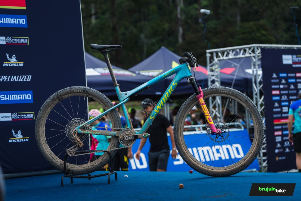

She, along with Gwendalynn, both have relatively “low” saddles ( not much seatpost exposed), which makes their effective STAs very steep.
Effective STAs are measured with the saddle at a specific height and are only really accurate at that height since the actual STA is usually much slacker.
This means that people with more seatpost exposed experience a much slacker effective STA and either need a steeper actual STA or to push their saddles further forward..
Since these two examples are somewhat extreme examples of one side of the curve, and something like Blevins’ bike being on the other side (a somewhat ridiculous amount of exposed seatpost) things probably work out pretty well for most people in the middle. :balance_scale:
This is Blevins on his Epic 8, on the Epic WC, it’s not like this.
I must have some minor trypophobia… I don’t think I could handle that seat. :grimacing:

He’s on the exact opposite side of the spectrum on his WC. It’s slammed full forward.
I’m guessing by having those slammed in either direction he’s splitting the difference and getting a 75.0 effective STA on both bikes and then he can run the same cockpit and have them feel very similar. Either way, what pros do is not what joes should do.
