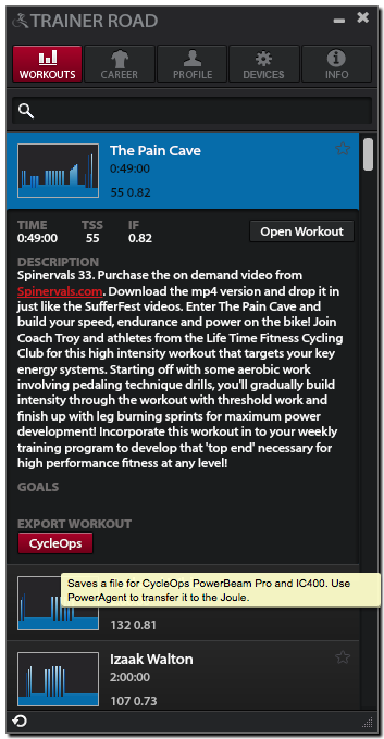

Pick a workout in TrainerRoad and download the powerbeam pro file. The workout uses your FTP so make sure yours is set. Pressing the CycleOps button brings up a dialog to save the cycleops xml file locally.

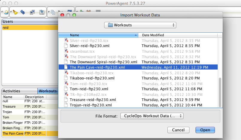

Open PowerAgent software and choose File->Import->Workout.

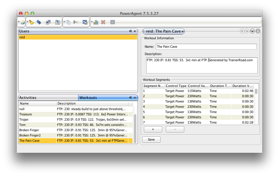

Edit the workout if necessary.

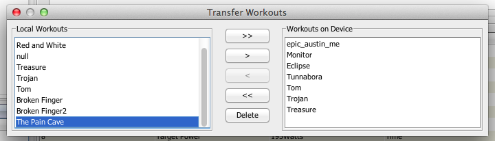

Transfer the workout to your Joule 2.0, 3.0 or Powerbeam Control unit. Choose File->Transfer Workouts.

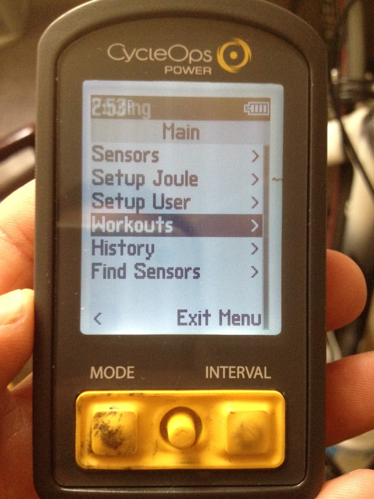

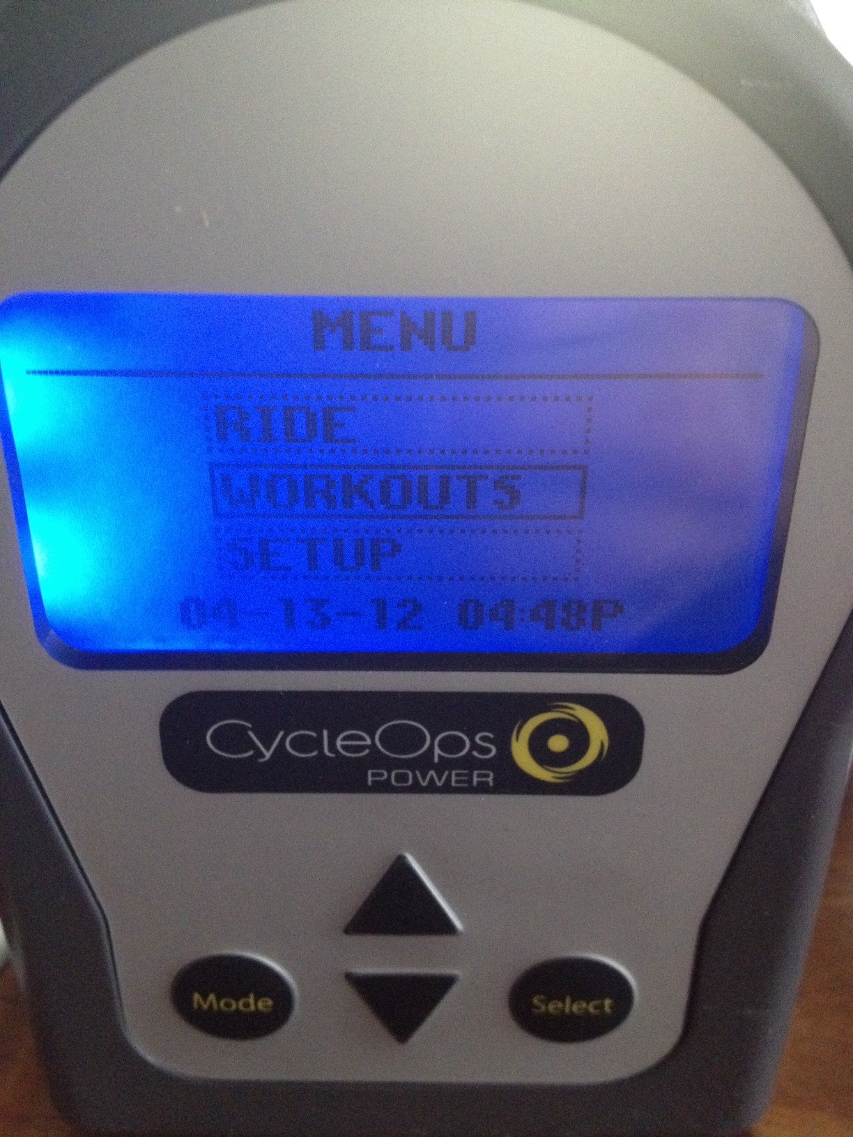

Here are some pics of the Joule 2.0 and the original PowerBeam Pro head unit. The Joule 3.0 should be similar but I don’t have one to show you 🙁 Ray has some great pics of it on his website, though.

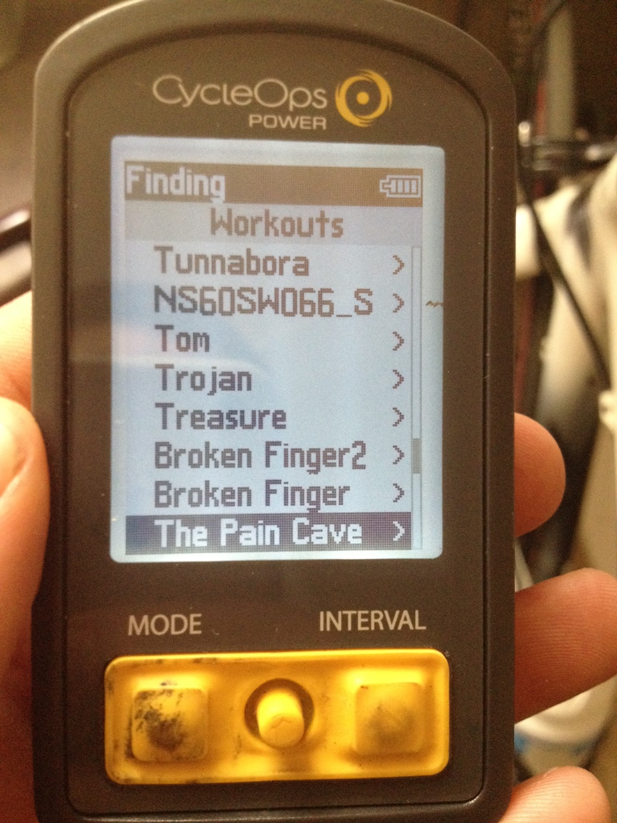

On the Joule, press Mode or Menu to get to the main menu and go to Workouts.

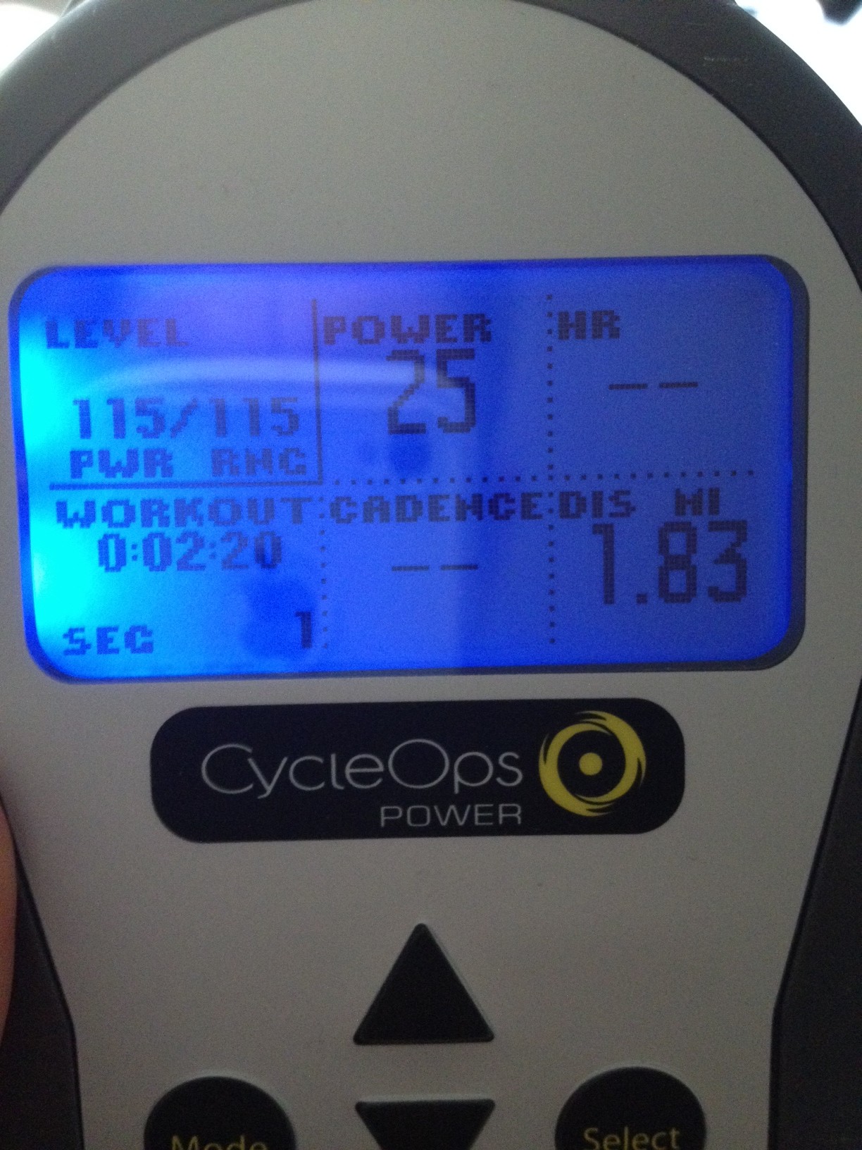

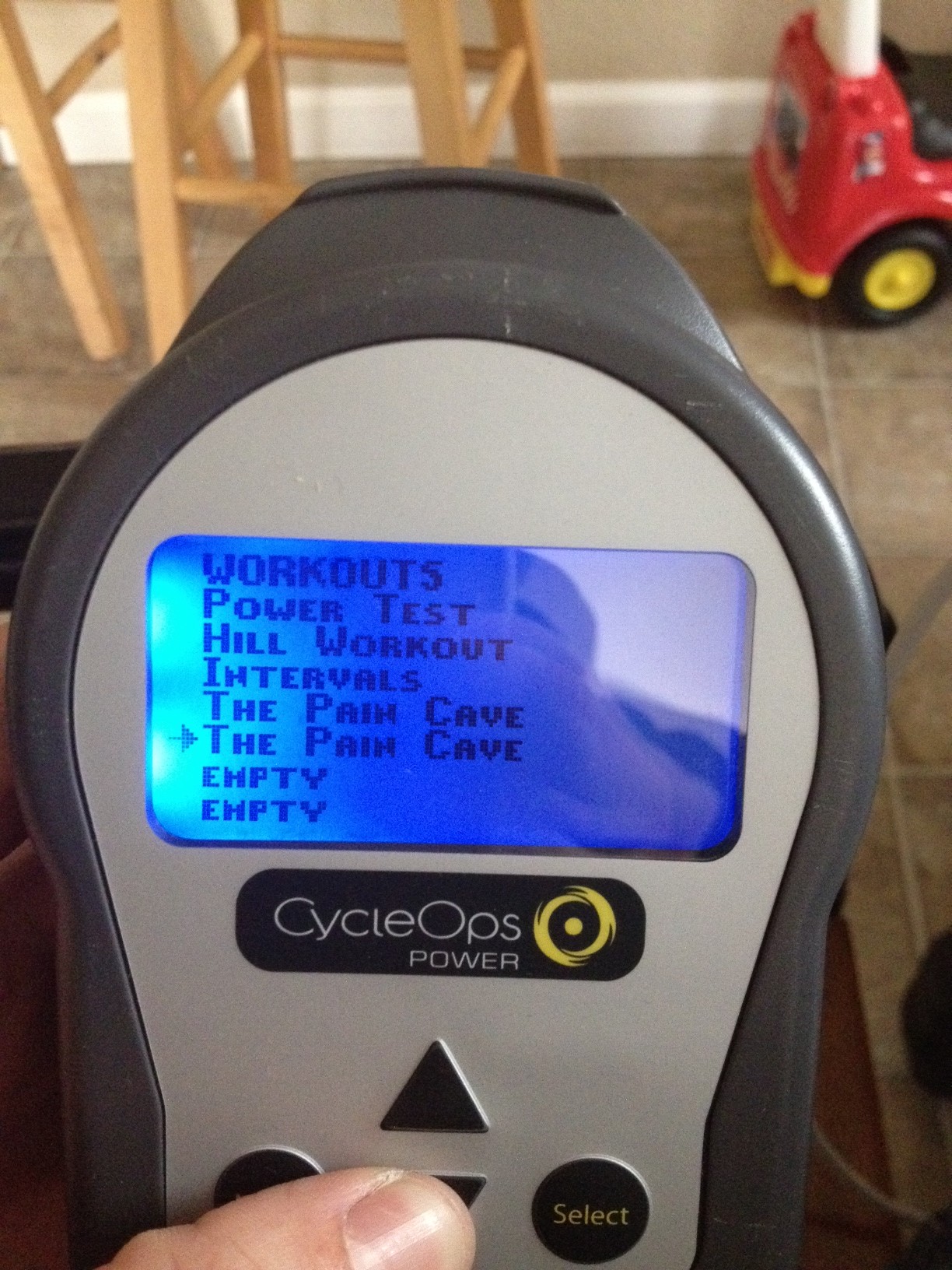

Select the TrainerRoad Workout.

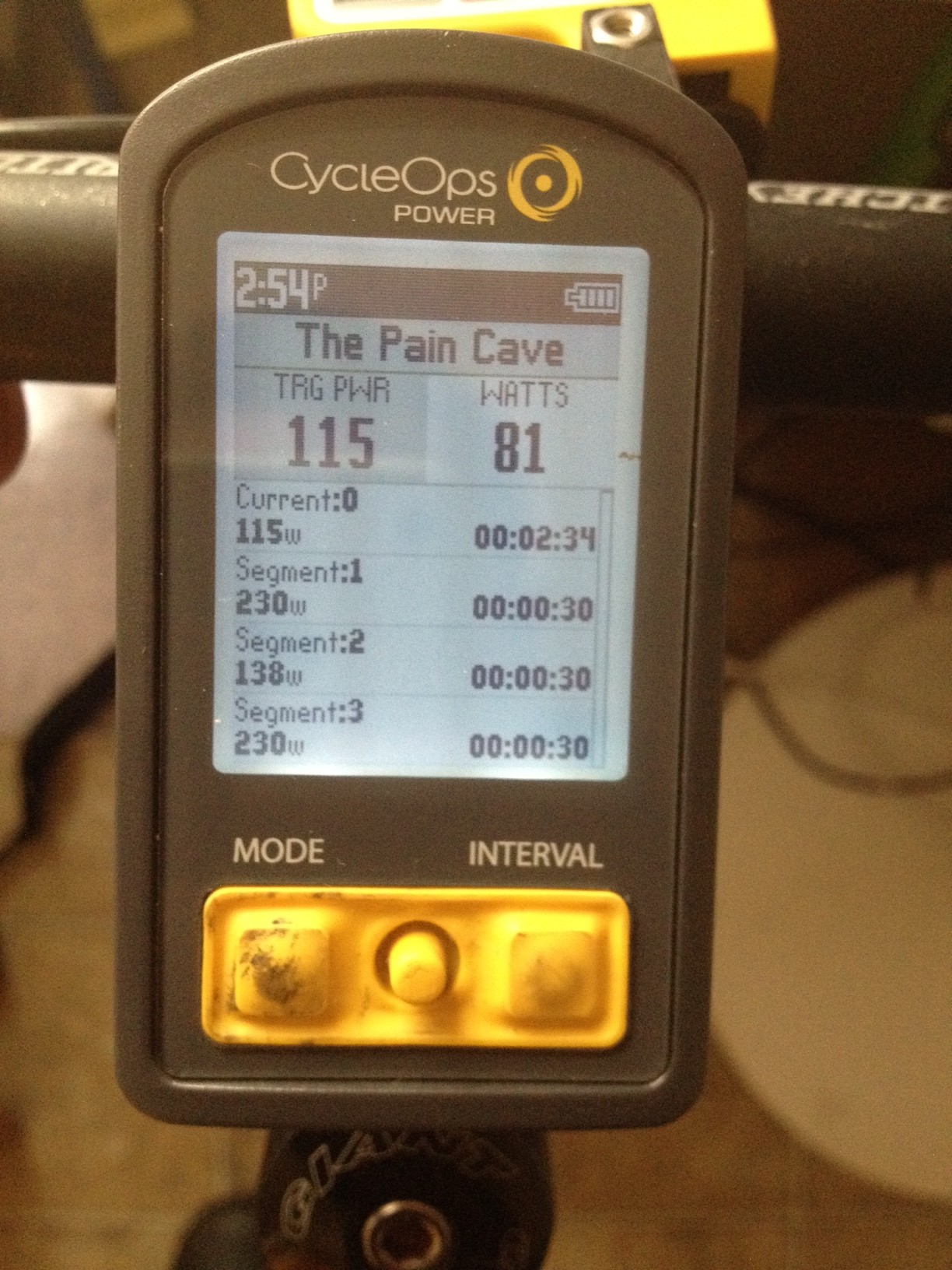

The Target Power and watts/power will show if the RU is paired.

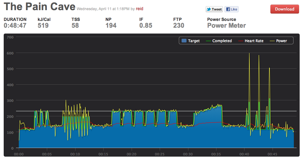

I did this workout the other day using this. The Pain Cave
It works great for longer intervals. You’ll notice the high spikes in the second set. Those were high cadence efforts where the PBP just couldn’t take any more resistance off. On the other intervals, you’ll see that it takes about 10 seconds for my power to climb up to the target power. The target power displayed on the Joule changes right away but it just takes a few seconds for the resistance to change. You can obviously get the power up sooner by shifting or speeding up your cadence but that often will cause a dip as the resistance is lowered to match the increase in speed. You can see this on the 1st of the 6 90s efforts on the full size graph. My power goes up initially and then drops below the target. For the sprints at the end, I just shifted to my hardest gear and went all out for the 10 seconds. They weren’t long enough to let the resistance unit catch up with the target power. I might try switching these to target slope mode in the future.
