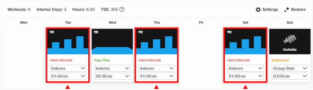

Helpful Tip For Finding Balance: You can set any workout to be done outside. For many athletes it can be helpful to set a workout to be completed outside even if they don’t intend to complete it exactly as it’s structured. Instead, they use the power targets to help guide the unstructured ride they do. This is particularly useful for long endurance sessions giving an idea of where to keep power and for how long. Or when swapping a key session for an unstructured ride, if the key session is a 4×5 at 4-minute VO2 Max workout, you can try to hit those marks during your ride.

If you have a challenging group ride scheduled on a day your plan calls for an easy workout, consider two options:
- Ride at a genuinely easy, endurance-level pace during your group ride.
- Swap your easy day with a planned hard day, adjusting subsequent workouts in your calendar to ensure adequate recovery time between intense sessions.
Be cautious about placing hard sessions back-to-back, as this can lead to excessive fatigue, compromising recovery and progress.
Plan With The 4 week Simulation Window
If you’re working to find a balance between your fun unstructured rides and training, use the 4 week Simulation Window as a quick planning tool. Add the ride to your Calendar (or swap it in place of a structured workout) and look ahead. You can see how that unstructured ride changes upcoming workouts and recovery needs. With it, you can decide whether to move or replace a session, and see how you can best maintain progress with FTP Prediction.
