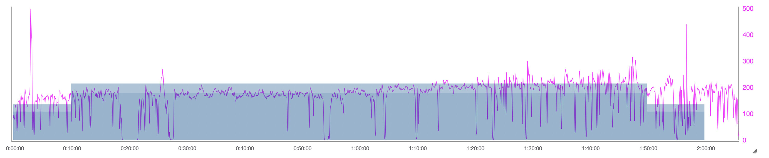

For those who might find it more helpful … here’s a screenshot of a test I did with Steve after the lactate test. This was to confirm we were at the correct wattage … the goal was to ride at the watts we thought was my LBP, and keep my BPM below 83% for an hour … and if I could, the LBP was confirmed. In this case, 83% of my max HR was 158, and I was able to ride at 240W (or something like that) for about 1:02:00 until it went above that level — so the test was confirmed. Once I eclipsed 158, he told me to ratchet the power down without exceeding that BPM for as long as I wanted.
This would be really easy to approximate. Maybe even easier than what I suggested in my earlier post: Pick a wattage you think you can hold for one hour without exceeding it, if you exceed it … try again until you nail it. Once you’ve got it, shave 5w off and train at that number until your HR drops consistently, and then reassess.

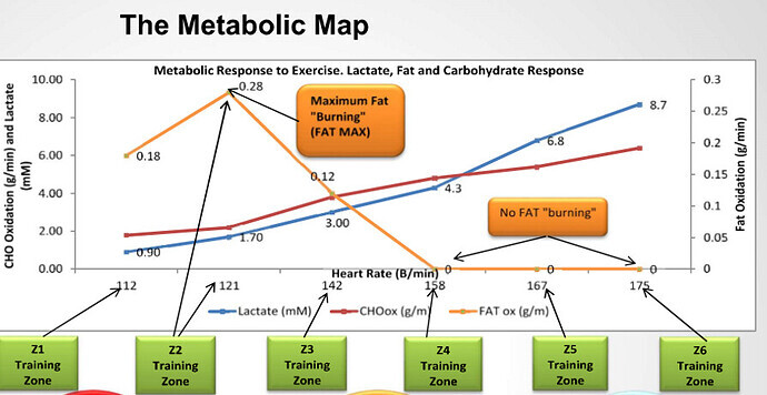

Why is fat utilization shooting high in the first 2 minutes? Any idea?
(I remember Kolie advising to ease into your long ride because fat metabolism takes some time to ramp up…)

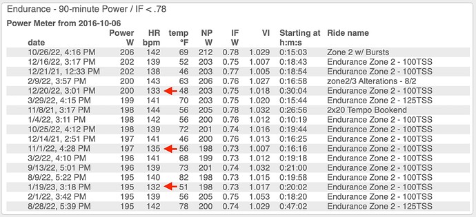

To be clear I don’t use a HR cap, except after a long time off the bike. I do a lot of 2 hour rides and have figured out an upper endurance power that is tipping point in terms of being able to recover and keep piling up 8-12 hours a week. That seems the as the fatigue/reward ratio comment you agreed with - I’m not sure of reward, I think it’s balancing training load against recovery from the fatigue that builds up over 3 loading weeks.

I don’t know. Perhaps it takes a few minutes until the system stabilizes. Dont know
Out of interest where is the data from? How was it generated?
