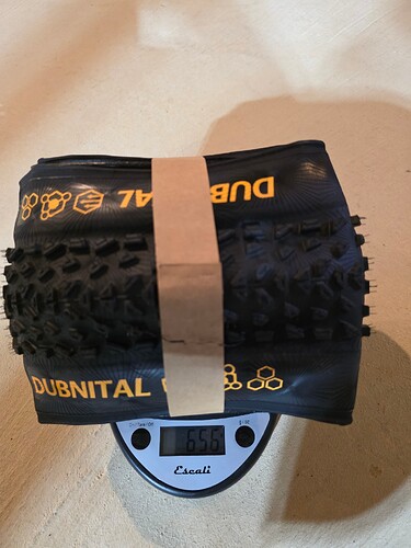

BRR Dubnital Race Rapid 2.4 results are available
Good results all around, but seems to be yet another severely undersized tire… Wonder if it grows significantly under pressure like some Schwalbe models
Looks Like a good alternative to the Racing Ray.
I can not honestly imagine having a different front tire than the Ray but the DUB may be similar but slightly faster.
I showed up to a very muddy slick race last weekend with the Ray and it did “well” enough to be competitive and was just as predictable as the dry. It does fantastic in the dry.
I guess, as a front tire I can put it on and forget it - just use it for whatever the conditions are and do my best and if the DUB can do that and be slightly: faster, wider, better puncture - its a great choice!
TL/DR - The Dub looks like a good mild upgrade to the Racing Ray with possibly similar “feel”.
The measurements are captured with the tire mounted on a 17.8mm rim. My pair of tires is ~62mm on i27 rims @22-24psi.
My comment was based on an apples to apples comparison with other tires also mounted on the same rim at BRR
When I first got mine out of the box I thought they looked small. Mounted them on 29mm internal rims and blew them up to 50psi and left them over night.
They measured 2.4 and when let down to 17psi retained that width.
So far very happy with them.
