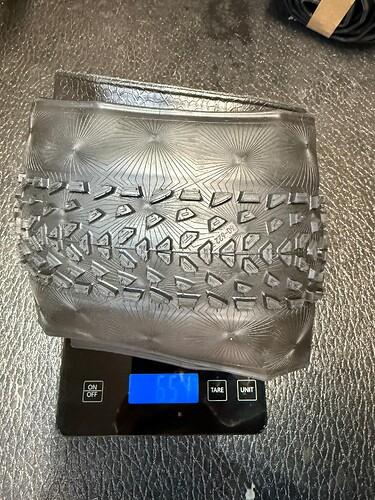

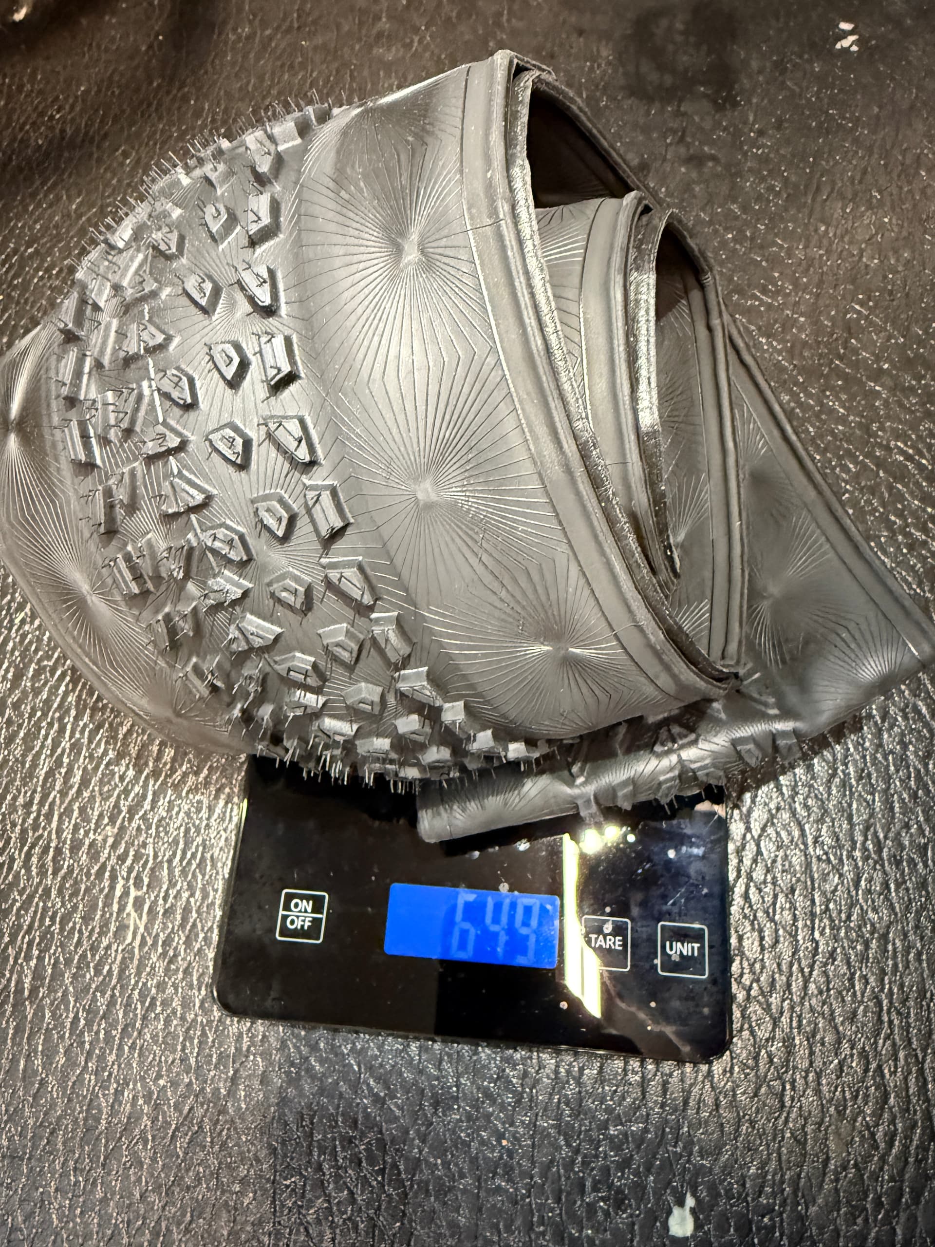

My tire of the month club shipment from Bikeinn just arrived. Photo dump with weights. Python Race, Dub Race, and a Rick XC to compare.
