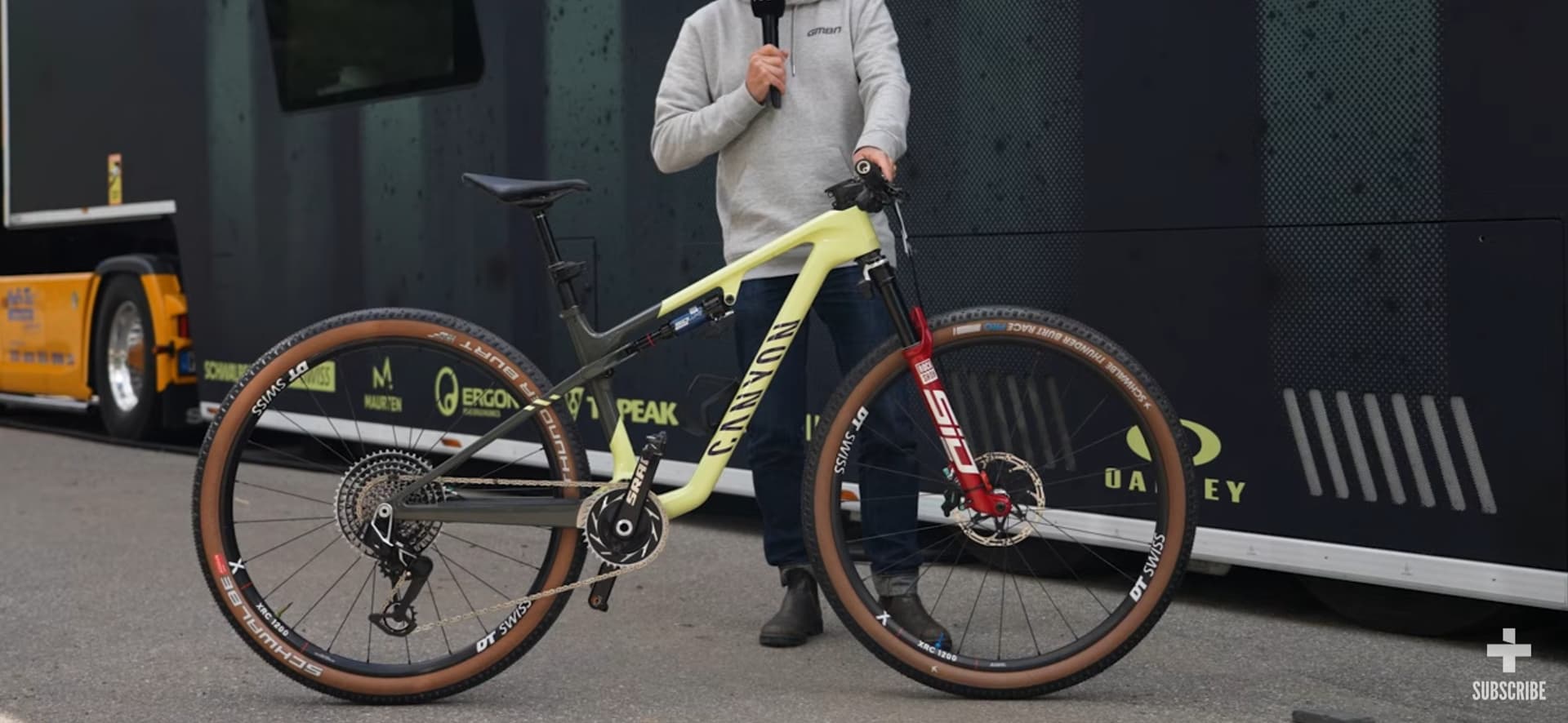

New Aspen “AT” being spotted at WC XC races. Usual Aspen pattern but with taller lugs. If they maintain the casing size and offer it in the 170tpi version I might be tempted
Sounds like it comes in a 2.35 vs their 2.4WT, but agreed, very interesting tire!
Yes, in the UK too. Best described as ‘lively’, I’d say. What I expected from a fast hardpack-focused tyre.
