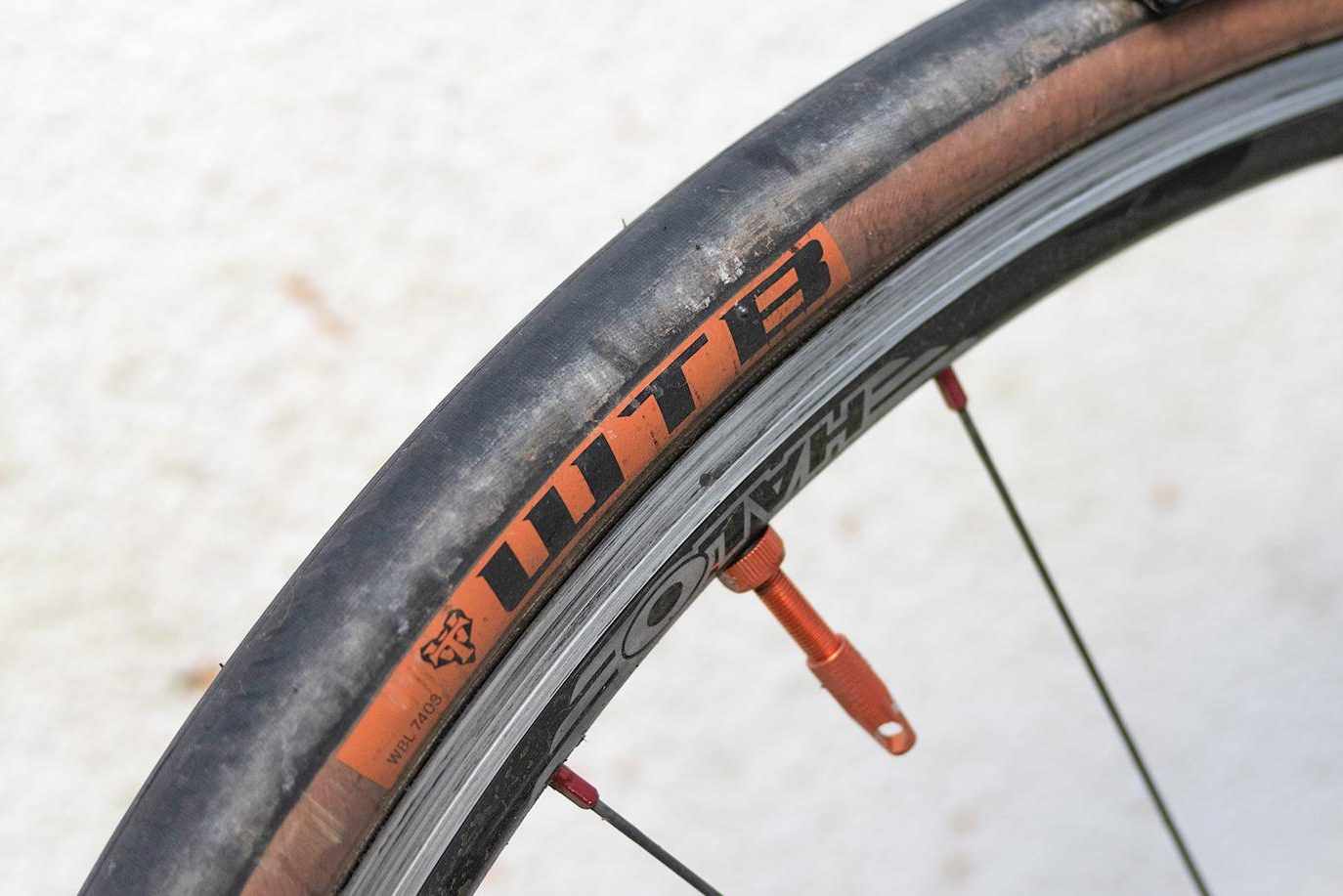

Out of those 14 only 2 jump out as being tubeless (topic of this thread). Those are the WTB Exposure and Hutchinson Sector 28. I’ve tried the Sector 28 and liked the road feel but unfortunately had issues with multiple tires.
