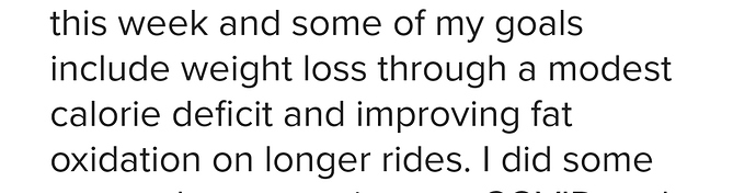

This thread would do well to remember what the OP said
I think we all agree that performance in a high intenisty (effort requirement) competitive situation will suffer if you cannot process carbs…ultra distance events less so.
What we are talking about here is fat loss, they already acknowledged that a calorie deficit will be employed and they’re looking at boosting the loss by using fat as a fuel.
Now, whether or not this can be accomplished in the short to medium term is open to debate.
