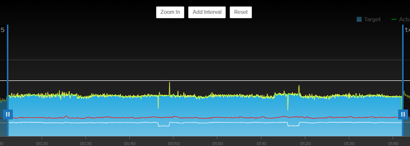

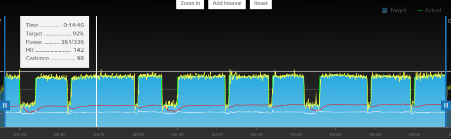

Here are the two most recent ones (I’m not doing a ton of sweet spot right now due to the time of year - I’d have to dig around to find other examples)
Gibralter -3 (subtracted the warm-up and cooldown)
Tallac -2 (again minus the warm-up and cooldown)
Ok so you’re not comparing apples to apples? I misunderstood your point I guess. I can update the data once I’m back at my computer if you want, but that workout has a really short warmup and cooldown, maybe four minutes total

Here are the source numbers for the two
FWIW I did these two back to back Sunday, Gibraltar first
I think it depends on context and it feels a little like you’re moving goalposts
It’s easily possible to get more kj per hour with sweet spot workouts than with endurance workouts. That’s the point I was addressing because you’ve been claiming throughout this thread they were roughly the same
