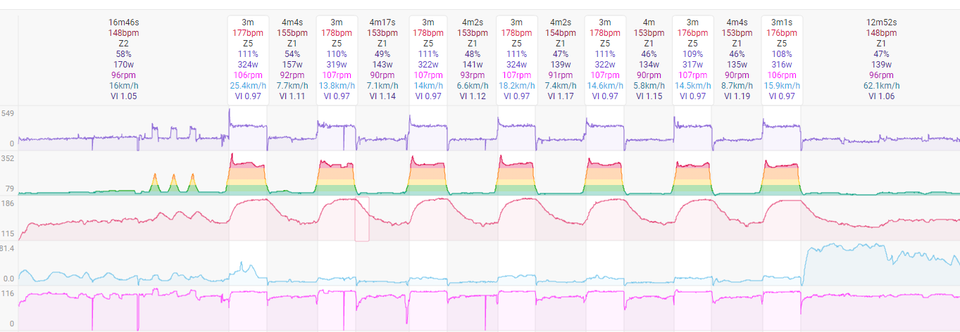

Yeah i did it!
First 1.5h Z2 outdoor ride and after that directly on the indoortrainer for 7x3min Vo2max!
And indeed 100-105 RPM is to low. Today i did 107-110 RPM and that was the trick. Thank you all for the help!

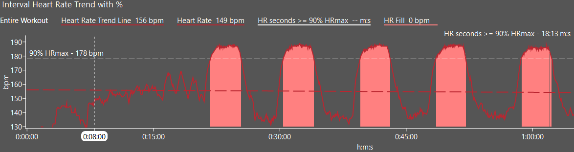

Yes indeed. The last interval i had problems with the HR strap.
Today 14:22 above 90% (with bad HR strap) and saturday 16min.
Yes but last saturday i could manege 324w for 3min… so i think it was not to hard. Thursday i will try again 7x3
Yes around 315

18min above 90% HR
