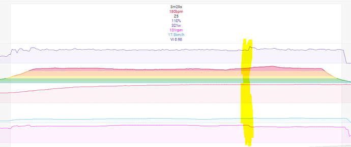

It went better than last week (and did it without ERG), but cadans 105 and higher feels unnatural, so when i shift my cadans going to 95…thats to low. You can see in this graph the moment i shift, so i have to learn to stay around 105-110 RPM.
In the yellow you see, power is going up and rpm is going down due shifting…

With the comments in this topic and @kurt.braeckel today it went a lot better.
Higher cadans, so less fatique in my legs. Today i could do 4x 3.5min and 1x 2min

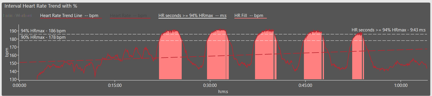

Tuesday i got 6:22 above 94% max HR. Today 9:43
I’m not there yet, but we’re making progress
With regard to HR, it is normal for time above 90% max HR to go DOWN as the block progresses. Don’t worry about HR too much. Yes, you want it to go high, and it should be higher than a threshold workout, but the sets aren’t less effective if HR is going down day to day. In fact, if you’re holding the same power set after set and HR goes down, that means EF is going up and that is a sign of progress.
I look for EF to initially go up (average of the interval and the last minute or so of each interval) then start to drop as you fatigue through the block and that’s a good sign it’s time for rest. That’s something you look at after the workout.

Time in HR Zone (90%+) increased each week, with my latest workout being over 14min above 90% HR (out of 18mins possible), which is really the goal, right? I could see lowering the power target a bit to extend the intervals (or add more) and increase that time spent at elevated HR and breathing.
