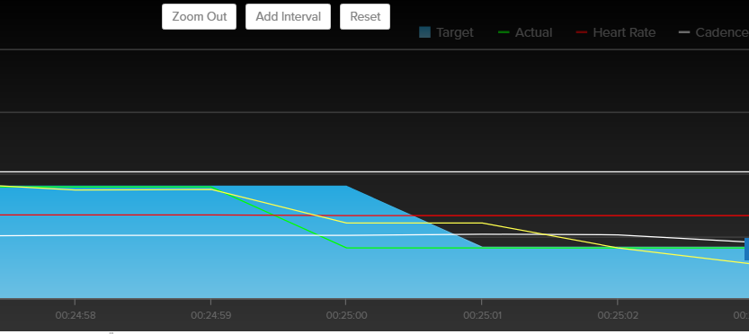

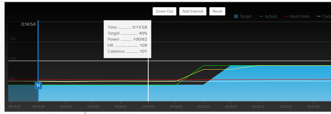

The summary gives the average power during the interval, as measured. TR sends power changes 1-2 seconds early, to give reaction time to the trainer. Despite this, the trainer will probably be a little late hitting the target power at the start of the interval, but will also drop off from the target a second before the end. These two facts make the average slightly lower.
Here’s the beginning of an interval:
And the end of one:
That’s where your 1% goes. This said - do you think this difference has any impact on the efficiency of your training?
