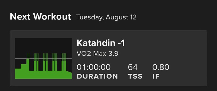

Which VO2 alternative to Katahdin?
I have this workout scheduled for tomorrow. It seems very overly complicated for an outside workout. Can I just replace it with something of a similar PL, but of more standard intervals without loosing out on something special about this workout?

So for example, you current prescribed workout (Katahdin-1) shows 4 sets of 8x15 seconds at 125% of FTP. That’s a total of 8 minutes at that percentage - albeit split over 4 sets and with ‘rest’ at 88% which is quite tough.

In addition, my question was also focused on why the system has given me this particular workout format and if, by changing to something else, I will be loosing out on a specific adaption….I will then need to weigh up whether trying to execute this outside it worth it compared to executing something of an easier format like Boltinghouse suggested above. I use a fenix watch so don’t have a lovely graph to follow and it makes it hard to anticipate what is coming next. I tend to memorise the workout in advance so I don’t get taken by surprise but when there is a lot of little changes, that is difficult to do.
In addition, could you possibly answer…..does the system build a training plan based on the rider being indoors primarily, and then just give the same workouts outside if the rider selects to do all their training outside, or does the system recognise that outside work has limitations with workout execution?
