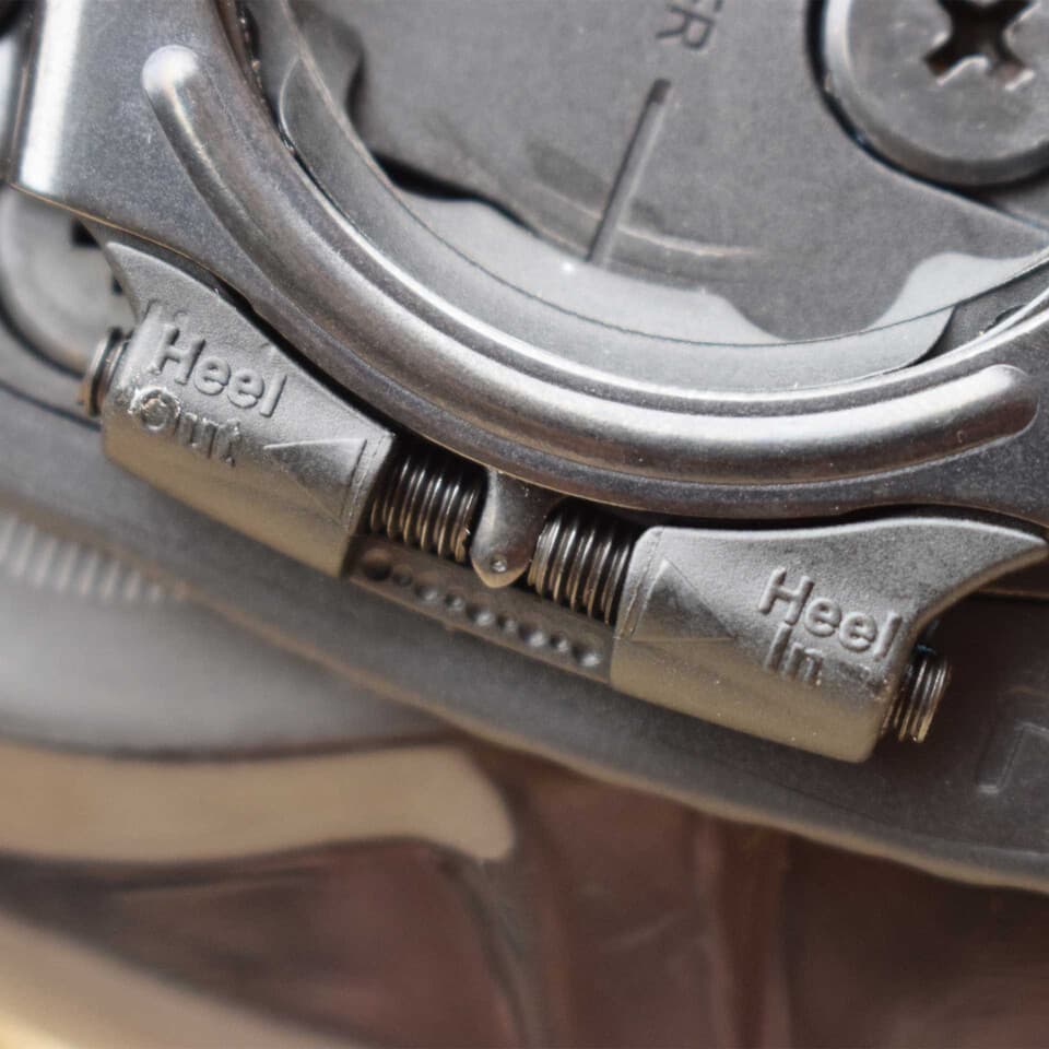

Yeah, we sell and fit with Speedplay at times. The core here is the cleat mounted to the pedal. Speedplay offers more than one, and the amount of float is controlled by the user with only one IIRC (the “X” I think, but will do a quick search to lock down the info).
Wahoo’s has 2 stock cleat options:
  • Easy Tension (Light Action in the old days?)
  • Standard Tension
Both of which include set screws to adjust the amount and orientation of float.
You can lock rotation to effectively 0 by running both screws in as shown. Or you can loosen either/both to control the amount and neutral angle between the tab in the middle.
This link shows it as well as other cleat systems.
ETA, I do think there were periods of cleats (mainly the East/Light ones) that lacked the set screws and just had fixed amount of float. Been ages since I did that related fit so I may be remembering that wrong. Per the current Wahoo specs, it sounds like they all come with adjustment now.
