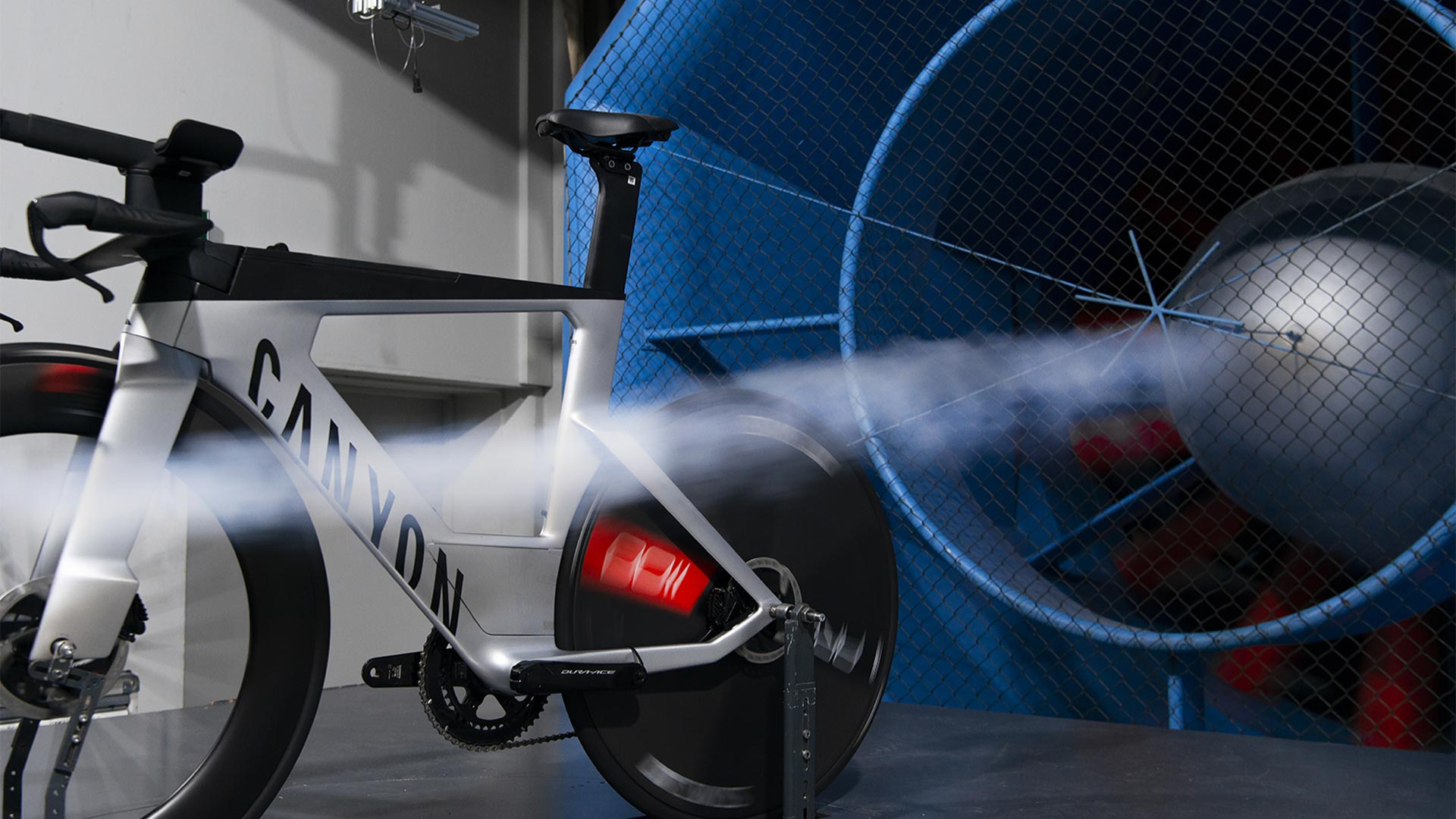

DT Quotes this set up (80/Disc) is 1.8W faster on average than a 80/80.
This really doesn’t correlate with the experience I have made with a disc wheel…
Not read the article - is it head on or over a range of Yaw angles? Or don’t they specify - I’d expect swissside to be pretty through with their testing.

Here’s the image from the article:
The article only says it saves 2 watts at 45kph with no mention of angles or averages.
That average could be skewed in either direction by looking at different yaw angles or by taking a straight average vs a weighted average for the yaw angles that they expect the disc to see in competition.
But based on that plot, the disc makes little difference out to about 10deg of yaw. It’s at 15deg where it’s saving you ~4W
Just saying, that this might be an indication that wind tunnel and velodrome testing (with straight air) gives an overly good result for a rear deep section wheel, while in the real world a rear disc might be better by a bigger margin than that.
