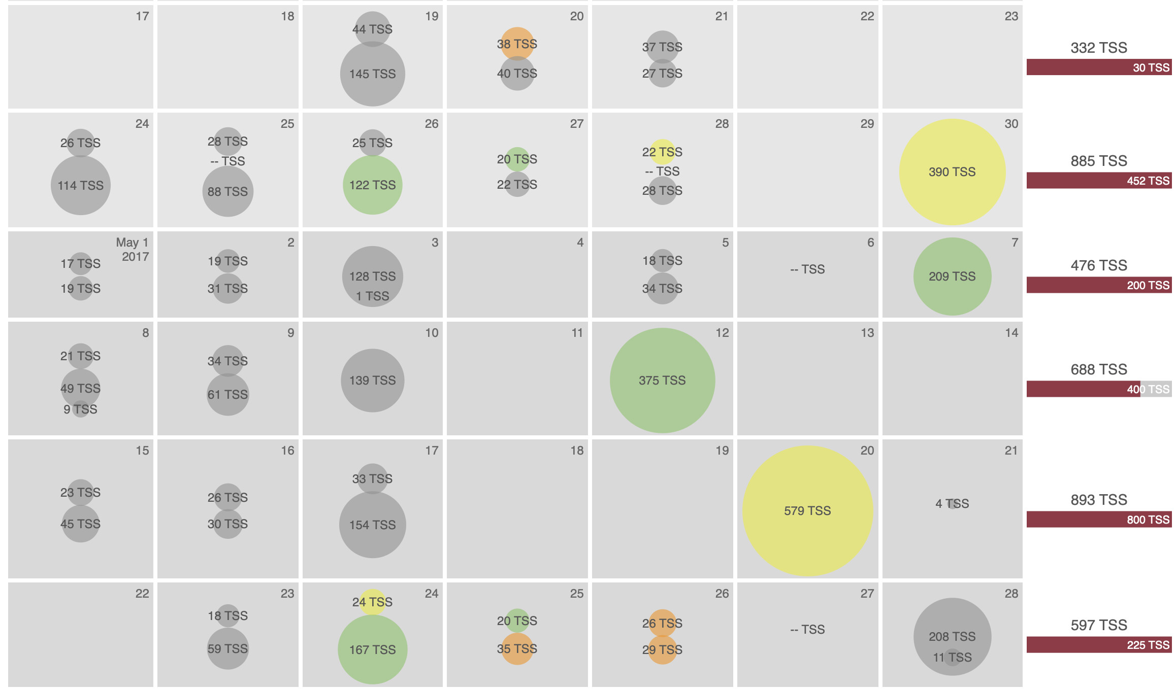

Its individual, and depends on your fitness. This is what I did before my double century (579 TSS) five years ago and not something I would currently do:
Century about 3 weeks before the double, and another century 8 days before the double. Set some short power PRs that still hold today (3 days before the double, and 5 days after). Fitness was really high and dialed back then.
With more longer rides under my belt I could probably do it again, but right now I would do something different.
