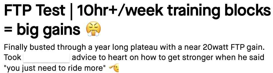

This advice doesn’t apply given the constraints you laid out, but over a month ago a 30-something was talking about his recent race experience (he started this year). We talked about it and I told him “ride more” - he wasn’t sure so I called out T-man a 20-something cat1 with some talent and pro ambitions (because who is going to listen to a guy twice his age that rides at his same level :rofl: ).
over the last 3 months he bumped from 6 hours/week to 9 hours/week to 13 hours/week and rode easy and stopped worrying about riding hard. And now he is faster than me :-1:

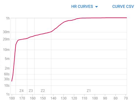

To that end this week I started a 3 week Vo2 Block based on all the suggestions above.
Wk 1 = 4x5, 4x5 and 6x4 in a 2 on - 2 days endurance - 1 day on - 1 day endurance - 1 day rest protocol.
Last night I did the 4 x 5s in a 1:1 ratio in a 60 min session.
Let’s just say the close your eyes and think of England analogy was spot on.
See below for time in zone data.
Notes - Picking the right gear is a process. Just go hard AF is the aim. Worry about everything else when you finished.
16m Above 95% hr from 20 mins work I think I got it right? Work in progress but these are going to test me.
