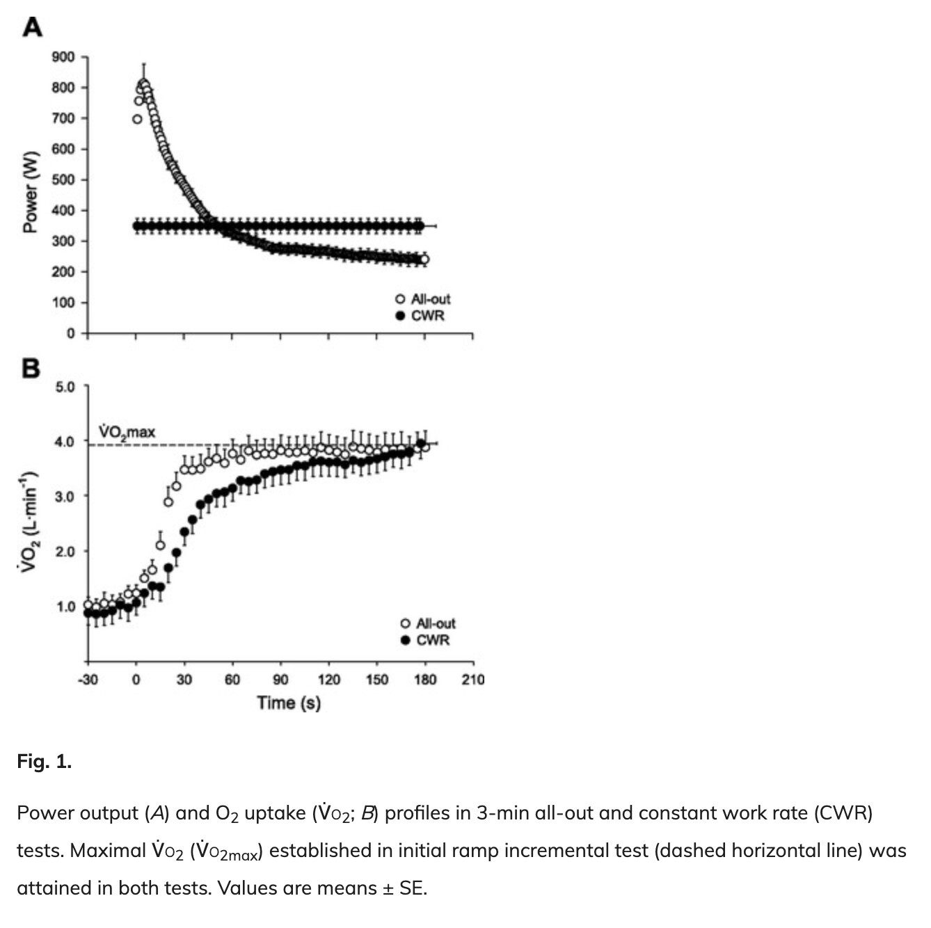

This has been looked at in the literature for a single bout.
https://journals.physiology.org/doi/full/10.1152/ajpregu.00761.2010

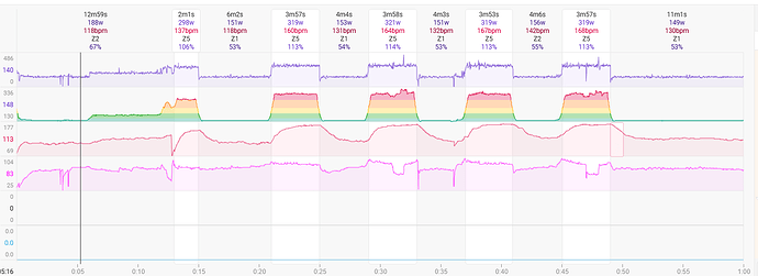

3 week post block update. Did a 4x4 workout on the trainer last night to avoid the cm diameter hail outside. I felt like absolute garbage during the warmup and almost quit. But decided to stick with it. But held 4 minute intervals at the same power I did my outside 3.5 minutes a few weeks back (and I did way more outside than inside during the block). I struggled a little on the first one but felt much better on the last 3. HR was a little lower too so seems like all good signs.

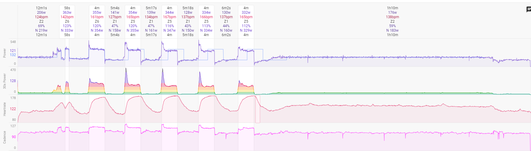

So I’m 2 workouts in my 2 Week VO2 block, first workout went like absolute shit couldn’t generate any power even though I was pretty fresh but nothing seemed to work. Planned was a 4x5 min workout but Power just didn’t come and 2nd interval was a total fail and the last one I also had to take a break…
Today was better did 5x4 min decided to have 5 min rest or more if needed, Power was still nothing to write home about, but I also seem to have a drop off when going over 105 rpm at least that what I feel, but HR, RPE and Breathing indicated that it should be a good VO2 stimulus, the 3 middle Intervals where somewhat hard starts, for the last one I didn’t have that in me…
Will try the 3rd one tomorrow or Saturday depending how I feel tomorrow, I think 4 minutes works better for me then 5.

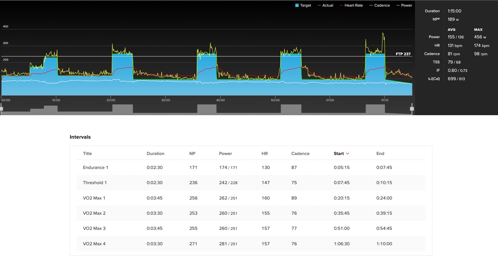

Heres what I did with Inspiration last week, it was hard but I felt like I could have done more
