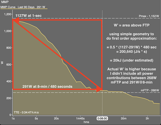

The dotted line between 200 and 400W is my FTP (270W), so if you calculate the area between the FTP line and power curve (or modeled curve), you have a pretty good estimate for W’ (assuming you have enough (near) max efforts).

Looking at “HIE = 30 (a variable) x (PP-TP)/1000” formula it reminded me its possible to use simple middle school geometry to cross-check, and as a ball-park first order approximation:
W’ is more than 20kJ, and again its a simple rough ball park number. I picked 8-min because a) the contributions above and below the red diagonal are roughly equal so I can use half the area of the square, and b) the small contribution of area below/beyond 8-min so this rough W’ calc is a pretty decent lower bound for a reality check on other anaerobic capacity numbers (where each has different assumptions).
