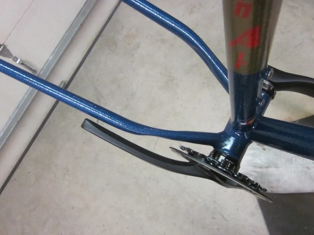

It’s mostly a frame/tire clearance thing.
The drive side chainstay becomes the major issue with clearance in terms of tire size and chainring size. Bumping out the crank gives a little breathing room in this area.
Also, front derailleurs can also be an issue regarding tire clearance, so as the crank moves outward so does the FD. That’s why you need the right FD to run with GRX cranksets. I’d assume there is a wide-specific FD for Sram as well.
If you’re going 1x, you won’t need to worry about the FD, but if you’re building a bike with big tires, there probably aren’t many downsides to getting the wide groupset other than the fact that it’s a “new” standard which will likely change down the road. For now, though, it’s the best option for bikes with tight clearances…

Why can’t I run more then a 46 chain ring
A larger chain ring is going to end up touching the chainstay…
not in all cases, some bikes are designed to take a 60t, moving the chain ring a few mm shouldnt change that.
Then the answer is nothing is stopping you, there are no capacity issues with shifting if talking about 1x.
