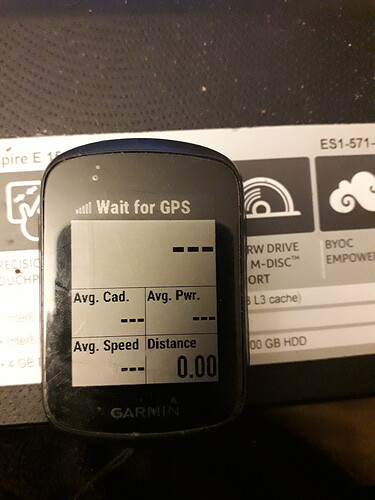

For TTs I run:
3 sec Power (primarily what I occasionally look at)
Ave Cad
Ave Power
Ave Speed; and
Distance.
I’m wondering if I should change Ave Power to Normalised for sporting TTs and maybe pay more attention to it as well as the 3sec power.:thinking:
