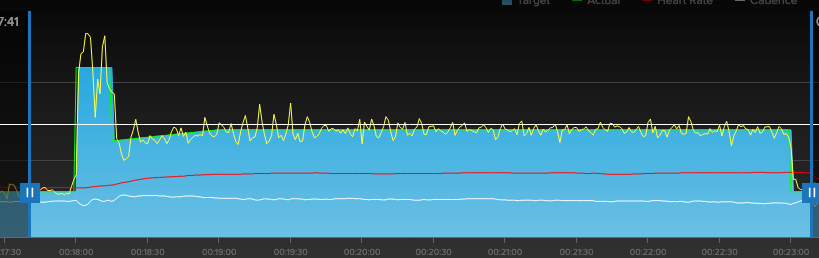

Just recently got an Atom and I am quite disappointed with it. On a work out tonight (see photo) it just wouldn’t settle down. Is this similar to what you have experienced?
How long is the example shown above? It looks like just a few minutes zoomed in and the power line looks quite normal to me.
Nothing sticks to an exact wattage, there will always be fluctuation unless you’re a robot.
From the time stamps on the crops, that is about 4 minutes shown. As you said, I think that is actually pretty decent power data for that timeframe.
Depending on what he is expecting or has seen with prior power data devices, he may be expecting overly smooth lines that are present from things like the Wahoo trainers with ERG Mode Power Smoothing on, or others like the Tacx Vortex, that all show very unrealistic power data.
Should it be that varied though? I’ve been using TR for two years now but this is the first time using ERG, I was able to produce a smoother liner without ERG on my bike with my dumb turbo.
The Variation on this example is +66 watts and -29 watts. At this point I actually had my eye closed to try and eliminate any potential bias due my own input to correct the fluxuations. During these big changes I am doing a relative consistent cadence of between 95-99
I’ve invluded the full interval to show the surge at the beginning where again it can be seen to overshoot +87watts then under perform to -129 watts then bouncing back again and down again. At that high above my threshold I am unable to recover from those two surges.
Input about the normality of this would be appreciated and any advice as to how to try and smooth it would be great.

If you look at the average for the interval I am sure it will be on target or within 1 watt unless you are doing 30s or shorter intervals.
There is always a spike at the beginning as it ramps up too hard and then has to adjust.
Normally on a 4 minute interval at threshold I might see power numbers +/- about 15 watts but it quickly readjusts.
