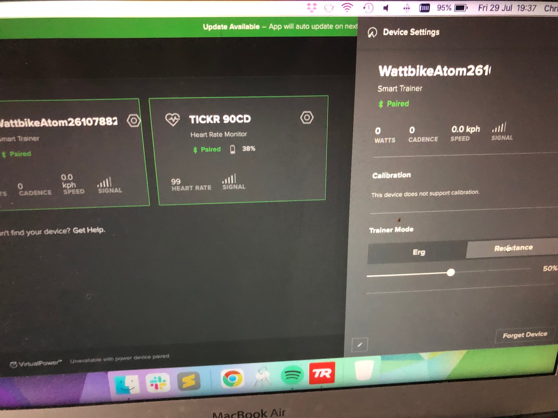

Oh you can’t switch to resistance mode.
Literally wtf.
Not quite true - booted old MacBook with old version of TR and can switch - but not on iPhone or iPad.

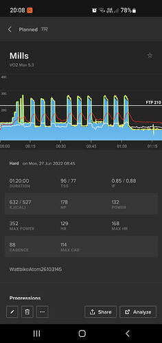

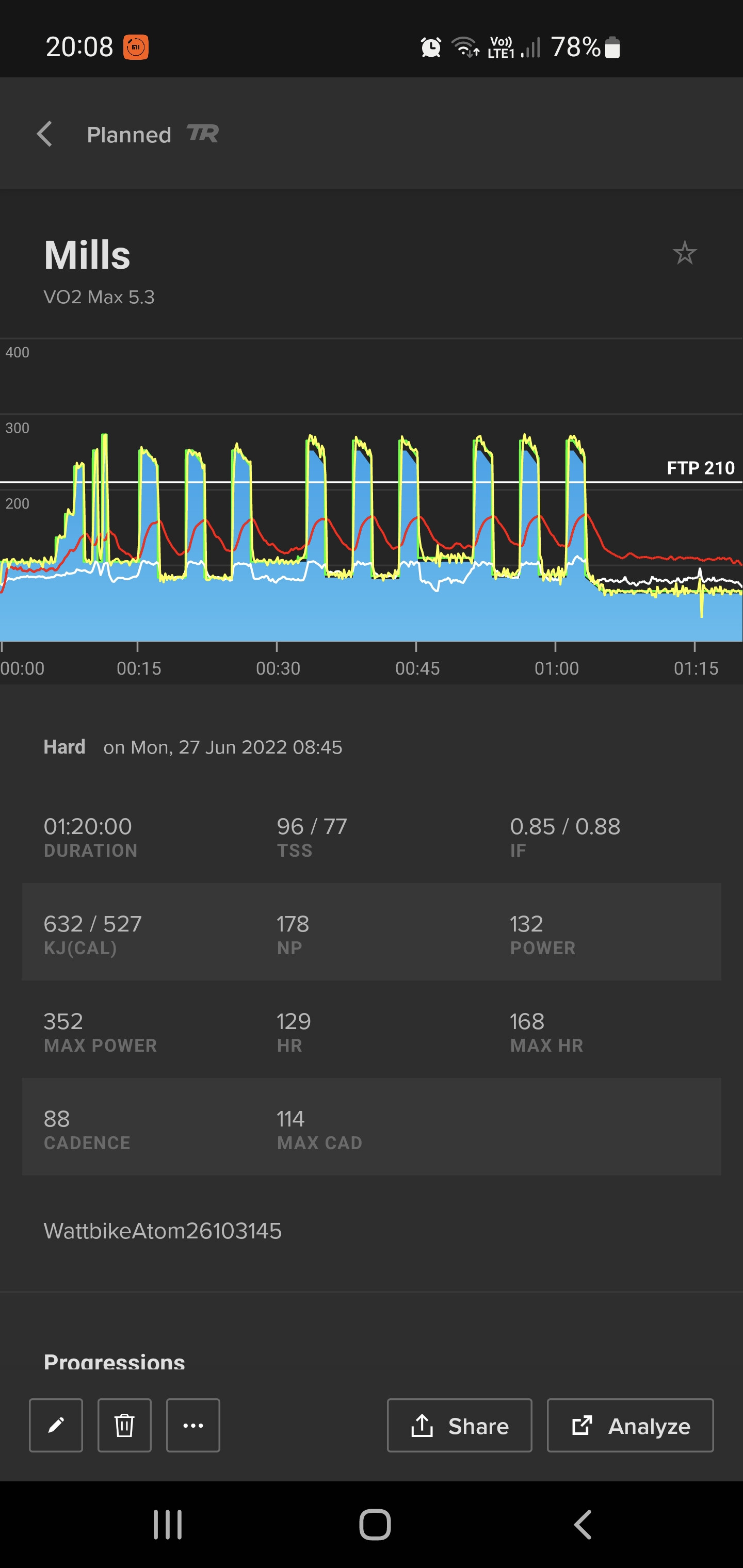

All my rides are on my Atom (2nd Gen) … I think they should be visible here:
