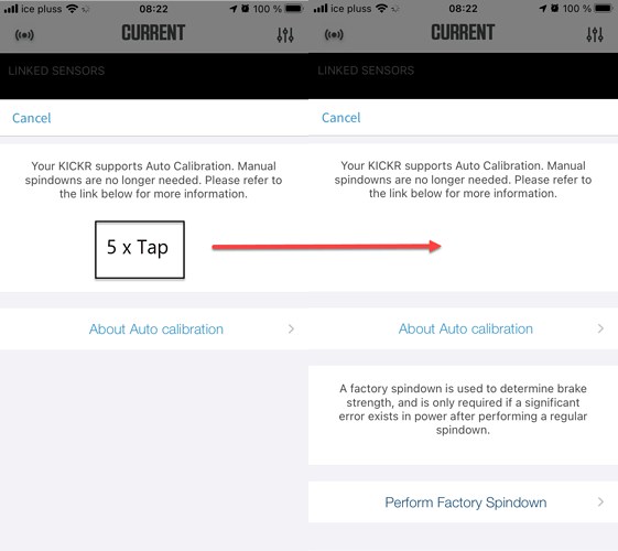

You should still be able to do the factory spindown on iOS though? I don’t use iOS so cannot test it.
EDIT: does this still work on ios?
Thx, option is available on ios.
