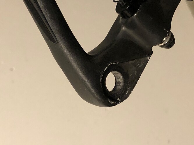

Here are some pics from my rear dropout. Could this be bad other than cosmetics?
you’re fine, it’s cosmetic at this point. If you were to continue doing this for a few years, maybe it’d chew away quite a bit. But the good news is that wahoo seems to be working on it and something should be available in the coming weeks
And… it happen to me. 2021 Emonda SL5 and Kickr V5. 2 1/2 months of riding. As of this morning, wahoo said they will have an update on Thursday for me in regards to adapter. Gonna do it myself tomorrow though (or atleast try) … As for my frame, is this a structural issue? There is a tiny lip the adapter made.
I’d say that it is probably fine but something I’d take to Trek and have them inspect.
I plan on doing the same thing when I’m back in the other location where my Emonda is. Fortunately I literally bought the Emonda and the Kickr from the same Trek store at the same time, so if it’s damaged I’m going to make a strong case for a warranty replacement.
I wouldn’t worry one bit about that. Mostly it looks like paint/resin that has compressed.
Looks fine to me.
