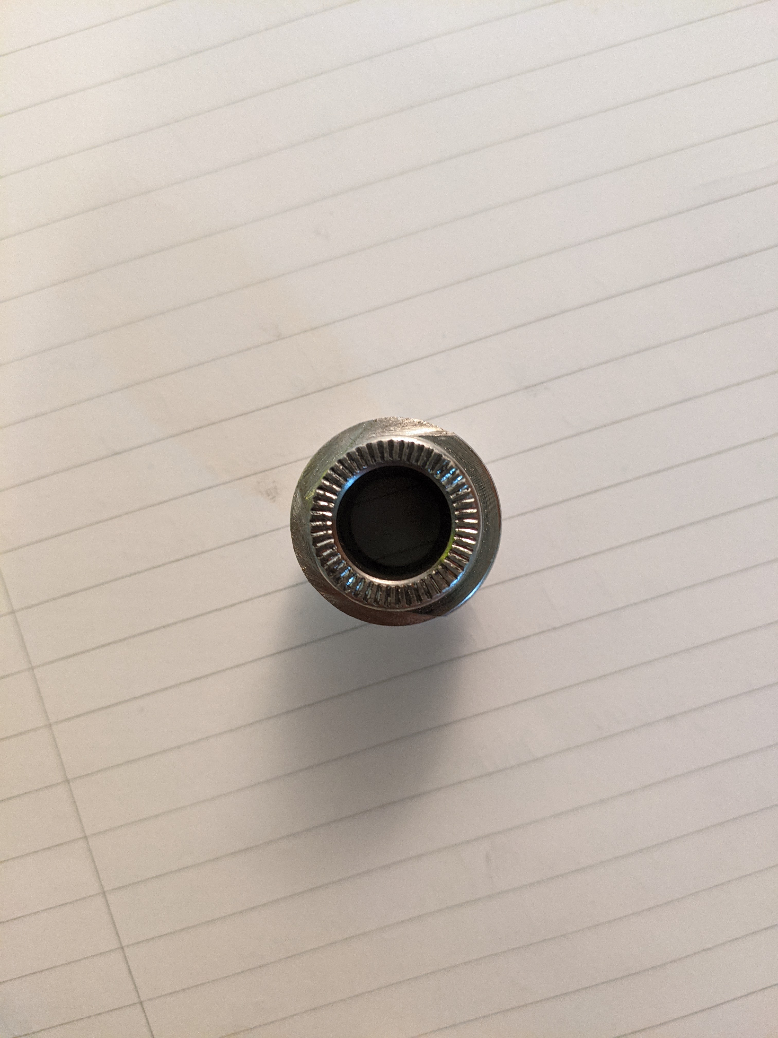

I think someone mentioned above - you could use a bench grinder to take off 6mm from the 142 side, then use the 148 side, which would clear the outer flange in the dropout (if I’m understanding the current incompatibility correctly). The other would be to use a nut and bolt combo to basically make a standard drill into a lathe. Tighten the Wahoo 142/148 adapter down in the nut/bolt, and use the protruding bolt to fasten into the bit chuck. Clamp the drill down to a workbench, grab a rasp file, and off you go. It might take a while, but you could end up with a DIY fix fairly cheap.
This is essentially what I’ve done. Living in a city centre apartment in Manchester limits my access to tools / workspace, so a lot of elbow grease and a generic £3.50 file from Wilkinson’s seems to have done the trick! (I’ve tidied it up a bit since taking the pictures)
