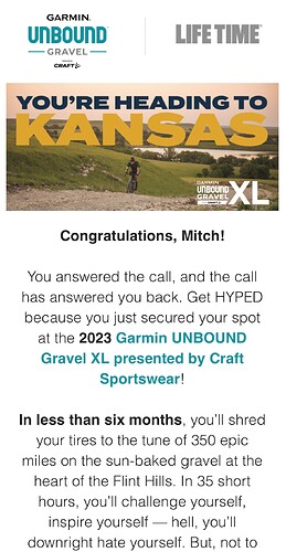

Well, guess it’s time for things to get serious! I did the “shorter” one last year, but 350 is quite a bit more than 200. Equally scared and fired up for this, preparation is going to be fun, on both the training side of things as well as equipment/self support.
Edit: failed to mention that I am just back in training shape after getting rocked by COVID and a post COVID bacterial lung infection. AIFTP has me at the lowest I’ve been since I started training, and I’m heavier than I’ve been since then as well. Starting from the bottom just makes the climb that much more satisfying from the top!
