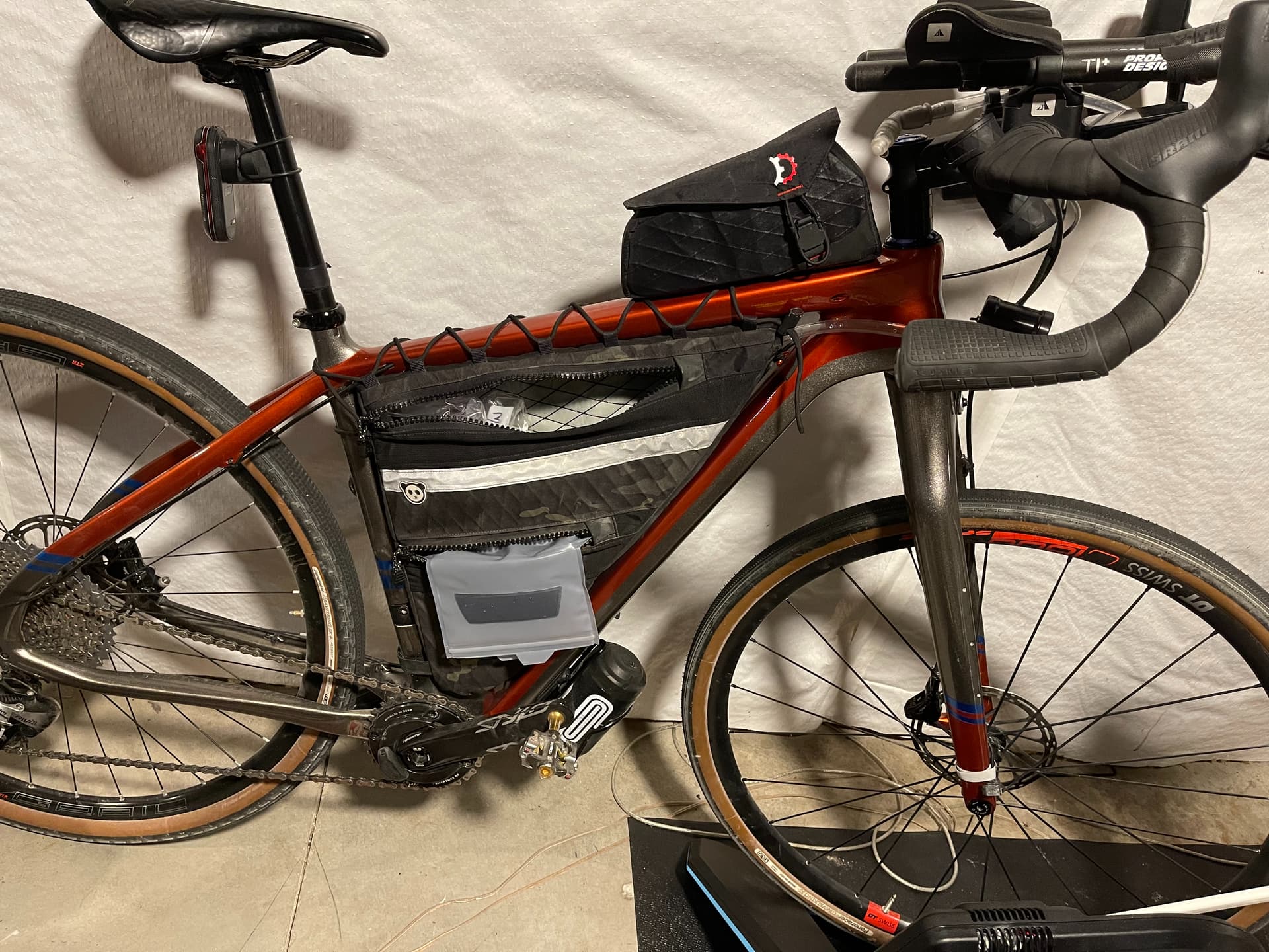

Here you go. This is more of a backpacking rig, and I setting up my new Diverge to avoid the overpack.
IMG_7947
Apidura makes a nice bladder that is shaped like a wedge to fit in the bottom. That is the flap hanging out.
This is very close to what my UGXL setup is going to look like, except half frame bag + 2 bottles and a larger saddle bag. And no aero bars! #aerowhat #aerowho. :wink:
Is that a lot of seat post or is the seat post just happy to see me? :stuck_out_tongue_winking_eye:
nice porcelain rocket FB!
Is this the XL or the 200 set up?
It’s a Salsa Cutthroat so basically it’s a mountain bike frame. Also, That is what she said

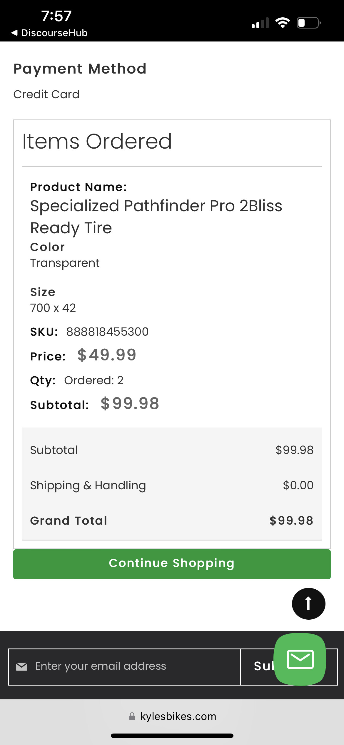

My LBS has them, Kyle’s Bikes,
Also, I’m trying track down the S-Work Pathfinder which the new lighter version.
You’re the man! Thanks!
