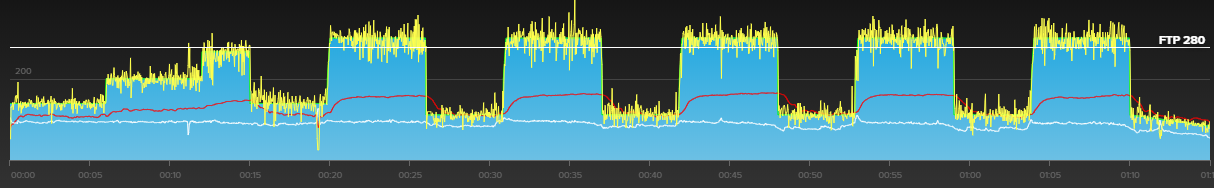

  1. I read up about powermatch prior to using and expected there to be a variation between the power (in terms of smoothness) between the pedals reading and the kickr core, but have been surprised by the amount of variation (40-50 watts from target power during an interval, or about an 8 watt difference in the interval target average). Just curious if this is normal behavior or if I am doing something wrong. I’ve included images of my previous three workouts below.

Your graphs looks pretty similar to mine using a similar Assioma/Kickr18 setup with power match. The variation is relative to how smooth you are at delivering the power and your selected cadence. I think of it as trying to cancel out a wave - if you stay consistent the software has a better chance to correct.

you graph looks all over the place compared to mine. I have the duo and Tacx vortex smart, using powermatch and assioma controlling the power. no issues tbh.
are you keeping your cadence as controlled as possible?

Other thoughts? It may be that I just need to work on producing steady pressure to the pedals. In the grand scheme of things a difference of 8 watts on an interval probably wont make or break me, but I guess I thought it would be closer. For example, today there were 5 to 10 second periods where I was doing an interval at 268 watts where my power was reading at 230 watts.
that’s not right. who is controlling the trainer? kickr or assioma?
it is definitely not a normal behavior.

I’ve used my Assioma pedals with power match with both a Kickr 17 and a Tacx neo 2. The previously shown graphs are typical for the amt of smoothing with the neo much smoother. I recommend doing a factory spin down with your kickr. Mine is within 10 watts of my pedals after having done so.

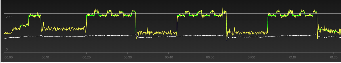

I have a similar setup to you and experienced similar issues when I transitioned from just the Kickr (2017 Snap) to the Kickr with Favero Duo. At first I thought there was an issue with PowerMatch or something wrong with the equipment, but I could never figure out what was wrong. So I really focused on keeping steady cadence and applying smooth power through the pedal stroke. Ultimately, I came to the conclusion that the power smoothing on the Kickr just really obscures your actual power output and lets you get away with pretty bad form.
Take a look at these two workouts, one from September of last year (when I made the switch), and the same workout from last weekend. My cadence and power output is much smoother.
Reinstein_1
Perhaps, unlike me, you really are experiencing a technical issue. Who knows? However, I found that focusing on my cadence and pedal stroke, while ignoring the power number, made the biggest difference.
