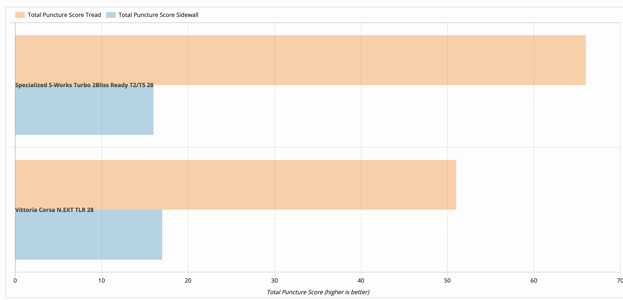

The interesting thing is that I just generated a new table, and only filtered on tubeless and 47 puncture resistance of the first gen GP 5000 TL.
No Continental tires on the list.

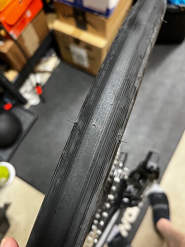

Ok I used a wet rag to swipe the tire - it was looking a little dirty and its Monday. Didn’t want to ride past one of my Wed night riding buddies tonight with such sorry looking black tires having random white stuff (?) on the side walls.
Behold:
nice flat spot forming in the center tread, like all my tires, and then I looked where the wear dot was suppose to be, and there it was!
Now I’m forecasting 1200-1500 miles for the REAR tire.
