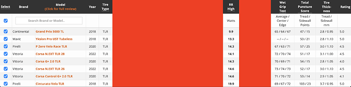

if I take BRR’s review of the GP 5000 TL and its 47 puncture resistance as a minimum, then filter out anything lower than 2.8mm tread thickness, filter out anything with a score lower than 4.0, and finally drop everything over 15W resistance (at my usual tire pressure) at I’m left with:
you can’t buy the first, and the last one is my current indestructible tire at ~20W resistance.

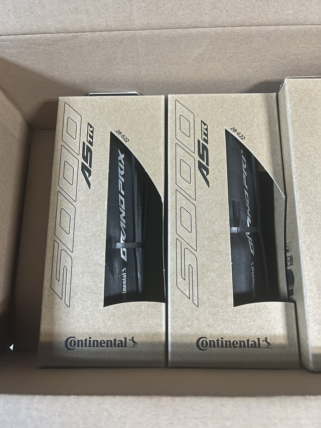

They seem to have just come out with a GP 5000 Allroad TR. I’ll be happy if this is a thicker version of the S TR. The older 5000 TL was thicker as well as slightly wider and taller in profile.
The BRR puncture score dropped from 47 on the TL, to 36 on the S TR. I’m hoping to see the 5k Allroad TR push up to a 47+ and sub 15W at RR High pressure (on par with Corsa N.EXT). I’ve never been a fan of Conti road feel, but I’ve bought plenty of 4K tube tires and 4 of the 5000 TLs.
