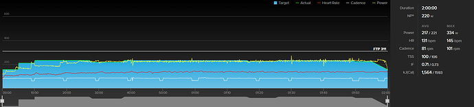

A couple of things. If you’re not regularly doing longer or harder z2 workouts then your z2 PL will be artificially low. Particularly if you’re doing z2 outside and not associating them with a TR workout. Your Wednesday and Friday rides are partially related to your PL in z2. Secondly, I’d recommend going off of feel and knowing thy self. I’m on “Xtra High Volume” plans and I do 2 hours on Wednesdays and Fridays. However, I adjust IF based on how my legs feel. When it starts to feel like work, I back down. When I feel good I go up a bit. That variance is between 65-75% FTP. Typically I’ll have a place holder workout and ride in Resistance mode, starting off low z2 and increasing as I feel better.
For example, this morning…

@MI-XC Would be nice to have an endurance session at nearly 220w. That’s a decent sweet spot interval power for me, lol.
