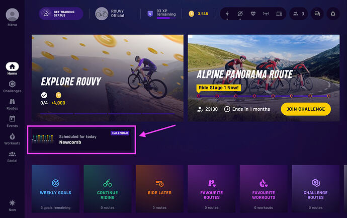

Today’s workout sits near the top of the ROUVY Home screen and at the top of the Workouts tab.
Click it and you get a preview where you pick which route you want to ride it on.
Hit Start Workout and pedal.
